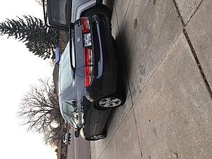

Hey everybody, in need of a daily driver I just bought a 2003 Honda Accord. This thing is a rare little gem, factory navigation, heated leather seats, sunroof 4 cylinder stick shift car. The car is in great condition and I got it cheap with very high miles (250,000), but hell, it ran and drove great, and its a Honda. I was driving to work, very low on gas and the car went into limp mode. I thought it was running out of gas at the time because it was that low, rolled into a gas station and filled up. The car ran and drove great. One day later, I whipped a pretty hard U-turn (with a full tank of gas) and the car went into limp mode (I assume). She wouldn't go past 3,000 / 3,500 RPM and bounced back like it was hitting the rev limiter. I limpted it home and restarted it. The problem went away (for now).
Plugged a code scanner in and behold 3 engine codes (I guess the previous owner was nice enough to pull out the check engine light bulb from behind the dash) My codes are as followed p0420, p2646, p2647. I only bought the car two days ago, and just got it registered today. I know its probably a bad idea, but I'm going to take it to work tomorrow anyway. My first course of action is going to be tapping the catalytic converter with a rubber hammer (i believe that I will hear rattles, and I believe I will more then likely end up replacing the cat), I am also going to test the OHMs on the vtech oil pressure switch to confirm that thing isn't fried. While I'm poking around I plan on removing the housing that the vtech oil pressure switch goes into, from what I understand there is a screen in there that could get clogged, and also I read about a second oil screen that is located somewhat behind the belt tensioner and power steering pump.
So to recap: I plan on banging on the cat, testing the ohms on the vtech oil pressure switch and cleaning two oil screens. How's that sound?
