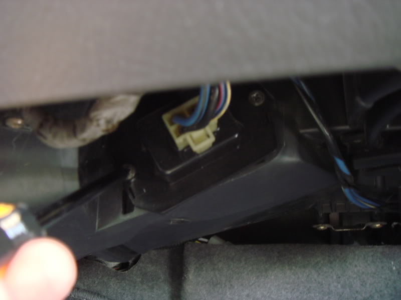

i just fixed my 2003 honda accord. i had the same problem, no air comming from my a/c & heater. it was the power transistor. it is located on the passenger side firewall. 1st take the panel off (under glove box) it is held by 2 clips. you can use an panel popper, flat screwdriver or just pull it down. at the firewall slightly to the left you will see a plug with 4 wires comming out of it. the transistor is held by 2 screws. unplug, and unscrew. ( you might need an angle screw driver, or tip.) i used a small drill and angled bit, with phillips tip. just pull transistor toward yourself once you have it unscrewed. replace part, and assemble in reverse order. ( you do not have to disconnect car battery). make sure you screw the new part in, and plug in, then turn car on and test a/c & heater. everything should work now. should take 10-20 min. to replace. part cost $70-85 (its a dealer item only).. make sure to call dealer to see if they have it in stock. mine did, but in some forums, they mentioned that they had to special order it.

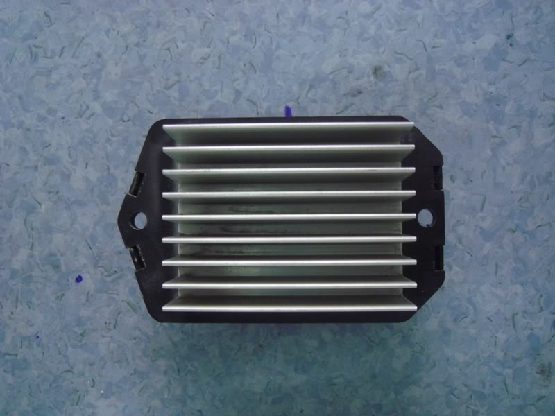

You will find the AC power transistor module here.

The defective part.
Remove two screws.

Notice the heatsink, the power transistor itself and the thermistor are attached to it.
