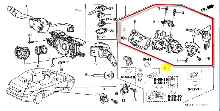

The steering lock assembly may need to be replaced. Honda list price is around $275 (local dealerships many times mark-up over list) and internet Honda dealer discount is approximately $200 plus shipping.
Your car has the immobilizer; however, the portion with the chip that communicates with the Immobilizer transponder is removable from the key fob. So, it may be possible to change the steering lock assembly that comes with with new keys and then just swap the portion with the chip from the key fob.
Btw: Lock-Ease works better than WD-40 for key cylinders. Some people even claim that was the only thing that help them turn a frozen auto key cylinder.
agscompany.com/lubricants/homehardware/179
