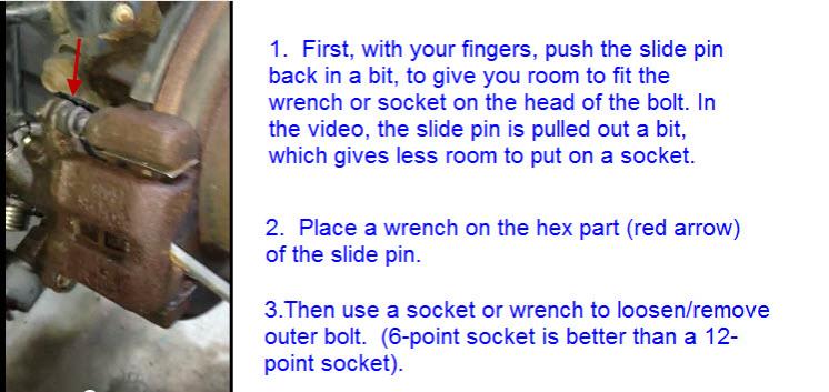

Did you use a wrench to hold the slide pin before trying to loosen the bolt? If not, it will just spin around.
On a side note, using the correct size metric socket is critical, and a 6-point socket will have less chance of rounding off the bolt head then a 12-point socket.

Old Mar 11, 2012 | 04:26 PM
In your video, the caliper slide pin is pulled out a bit, which gives less room for you to use a socket/wrench on the outer caliper bolt. With your fingers, push the bolt and slide pin back in to give you more room.
Then use a wrench to hold the hex part of the slide pin.
Now, loosen/remove the outer caliper bolt with a socket/wrench. 6-point socket is better.
I took a still picture of your video and inserted notes (attached).
