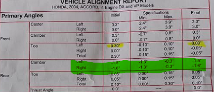

I have Honda Accord 2004 and I got new tire and did the alignment at local shop.
In alignment report rear Camber is out of spec and mechanic said that they cannot be adjusted.
Is it right that rear camber cannot be adjusted?
Is something I need to worry about?
Thanks.

Camber can't be adjusted. You are slightly out of spec, so I wouldn't be concerned unless you notice some issue pulling while driving or strange tire wear.
Most likely explanation is some slight wear on a bushing or possibly the rear spring due to age of the vehicle. Really out of spec toe can quickly wear a tire.
