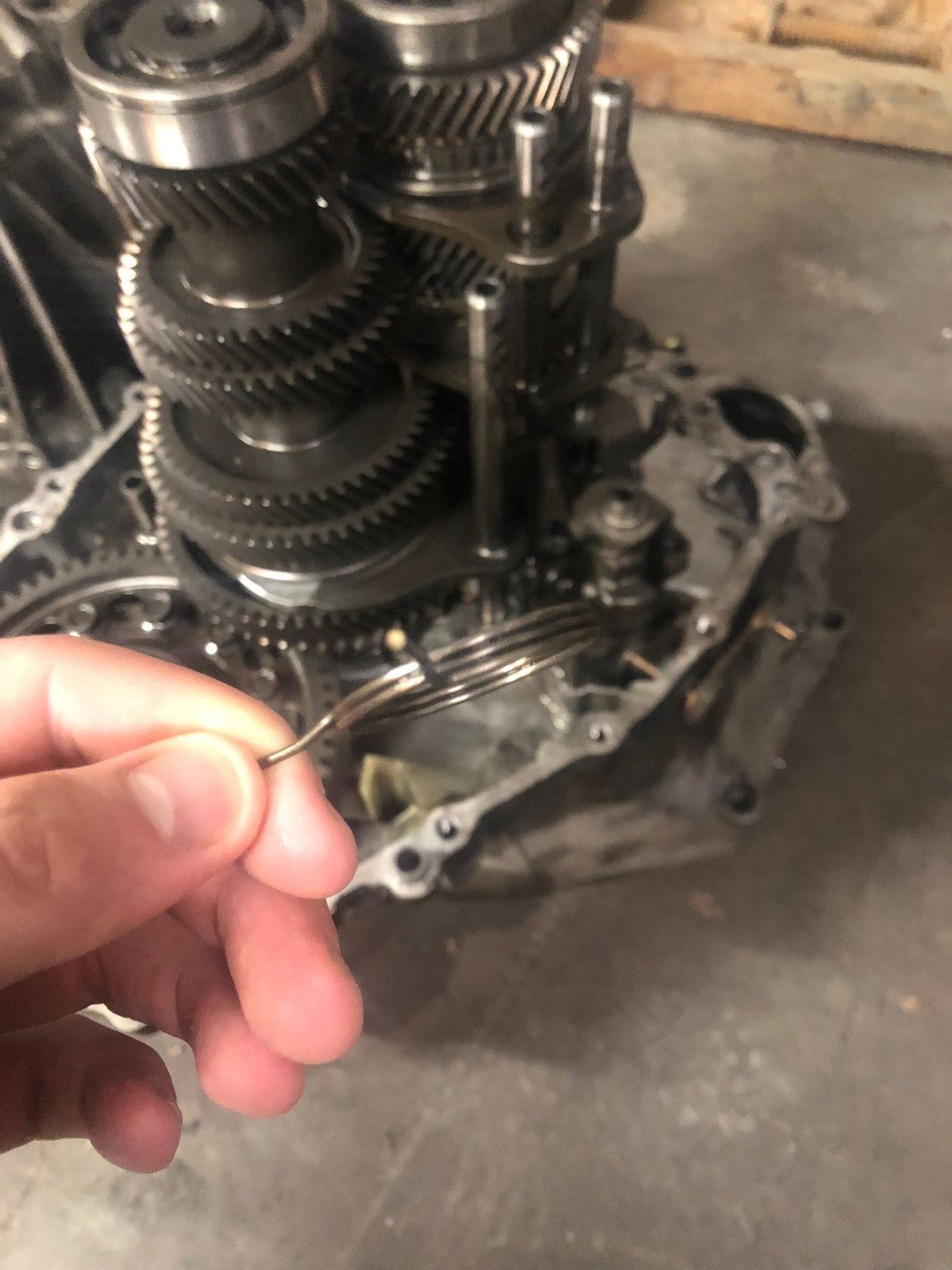

Does anyone know where this spring goes on a 2004 Honda Accord coupe v6 manual transmission.

Looked through my 03-06 shop for transmission disassembly and didn't see it. What have you done on your transmission so far?

I think I found it in the V6 manual section. See attached picture. It is called select return spring (#34) in the diagram.

yep that’s it thanks for the diagram helped a lot

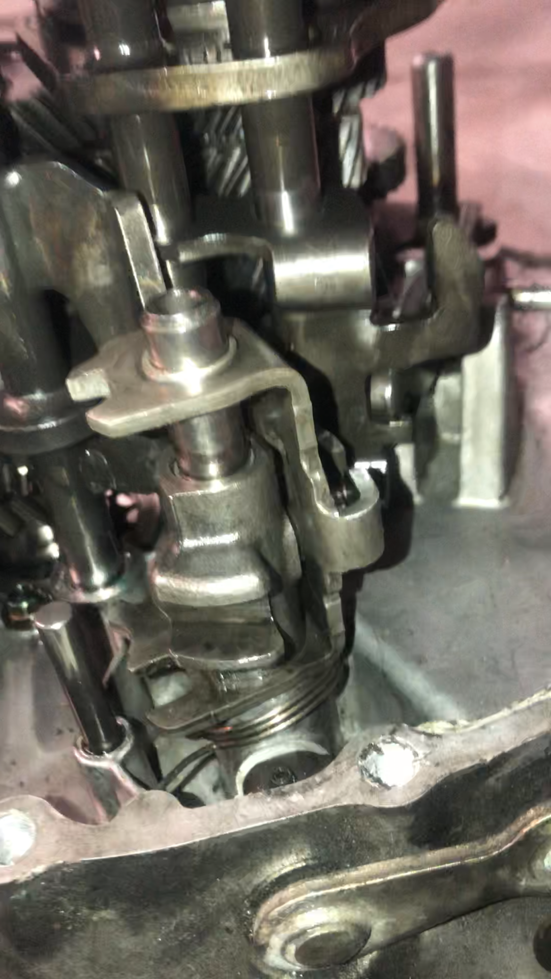

Does anybody know where how this is supposed to fit in on my v6 manual Honda Accord transmission, and is the spring supposed to be right there?
Old Feb 2, 2019 | 09:51 AM
Posts: 16,334
Does this picture help?
