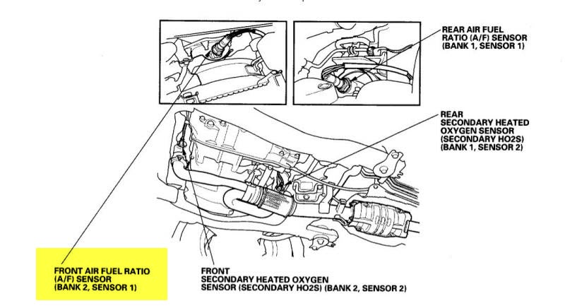

I went to Autozone and got the codes. The codes that came up were P0154 and P2254. I think those are oxygen sensor codes?
Old Jun 4, 2012 | 06:14 PM
It doesn't come up in any Honda references I have. I googled and found P0154 was heater circuit (Bank 2, Sensor 1) for Air/Fuel Sensor (sophisticated $$ O2 sensor).
P2254 is Bank 2 sensor 1 negative current circuit open.
Simultaneous electrical faults on both circuits of A/F sensor is suspicious. I suspect disconnected sensor or damaged wiring.
Any recent work on the car?
Old Jun 4, 2012 | 06:28 PM
Clear the code and see if it comes back; if it does, it may be the air/fuel ratio sensor needs replacement. Your car has two primary A/F ratio sensors and two secondary oxygen sensors.
Looking from the front of the car, Bank 2, Sensor 1 is the A/F ratio sensor is in FRONT (radiator side).

The bank-2 error codes weren't in my list either, which came from the 2003-2006 Helm shop manual. I had the 4-cyl manual & I never bought the V-6 supplement.
Old Jun 4, 2012 | 09:29 PM
Posts: 16,335
Those are both codes in the V6 section for the front a/f sensor (bank 2, sensor 1). Redbull-1 put up the pic from the manual.
