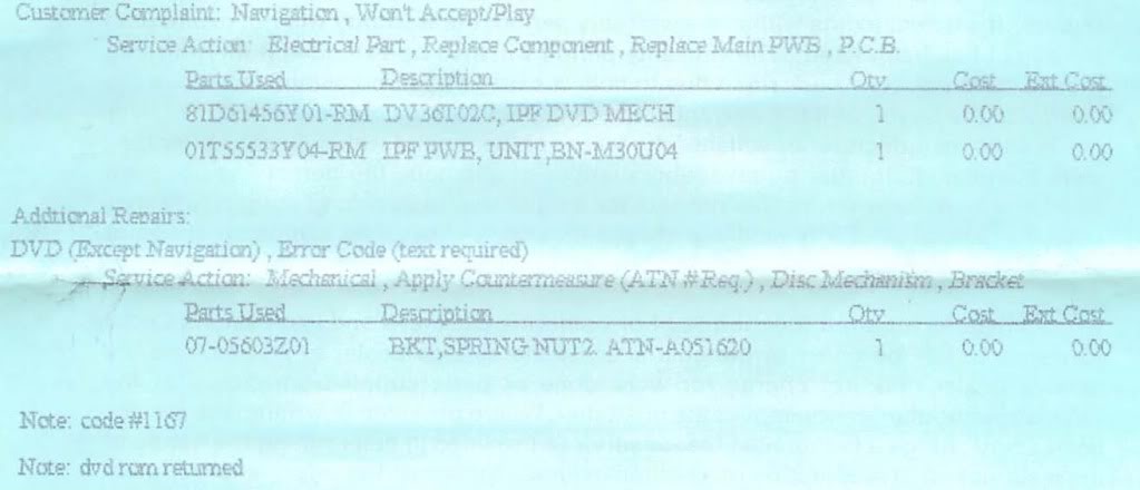

Default Navigation Unit Received
I got my navigation unit back from Alpine a week and a day after I sent it in. It works like it did when it was brand new. Here are the notes they included in the box:
After replacing the main board and the DVD drive I'm not sure what's left from the original navigation unit: the case, a few connectors, and the fan, I suppose. The note about a "countermeasure" for the disc mechanism involving a "bracket" and "spring nut" is interesting. Maybe Alpine has determined that the DVD drive isn't adequately vibration damped.
Anyway, all's well and I would recommend Alpine's service.
