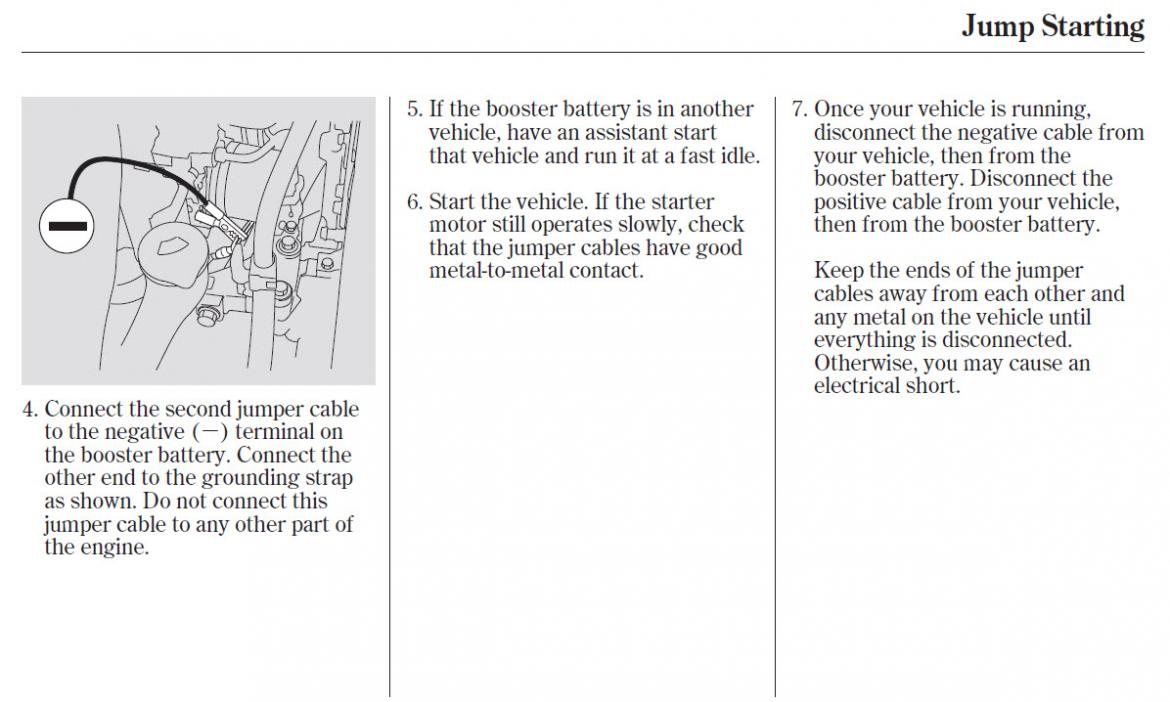

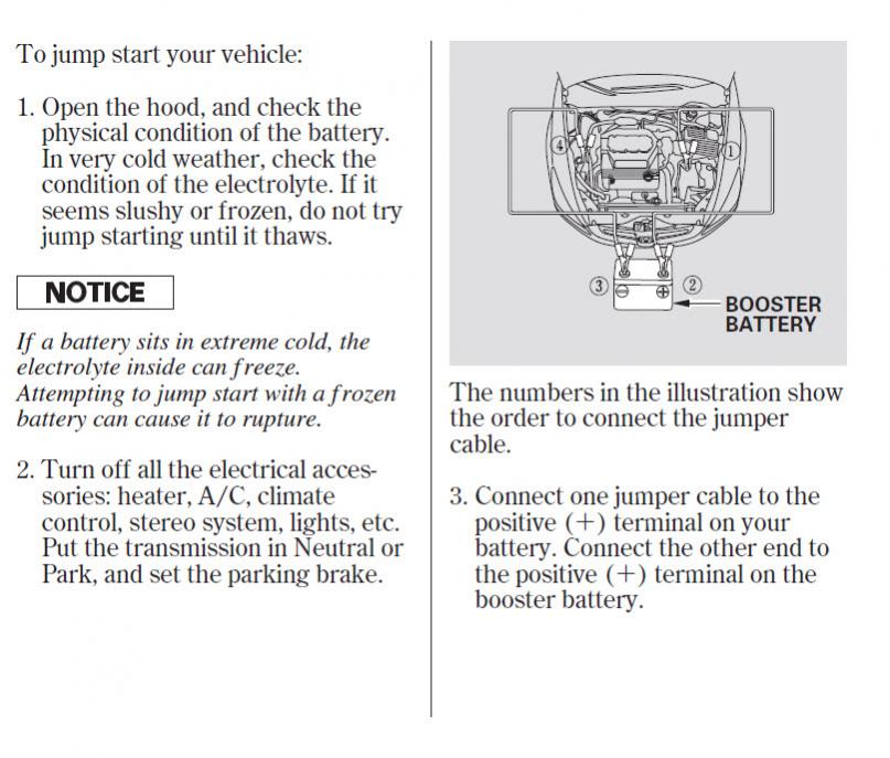

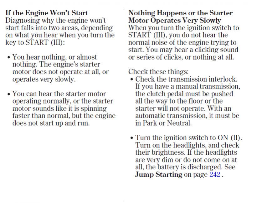

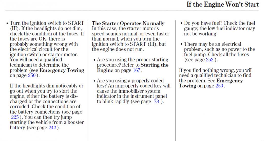

Hi Friends,
I recently bought honda accord hybrid 2005 model. My car not starting and started indicating battery is low. Could you please help steps to follow to start car. then I can take to dealer.
Thanks in advance
Sreeni

The owner's manual describes the steps to check when the car doesn't start and jump start the car. It the battery is discharged, then refer to the jump start procedures in the attached images.
Attached Thumbnails 2005 Honda Accord Hybrid-engine-wont-start.jpg   2005 Honda Accord Hybrid-engine-wont-start2.jpg   2005 Honda Accord Hybrid-jump-start1.jpg   2005 Honda Accord Hybrid-jump-start2.jpg
