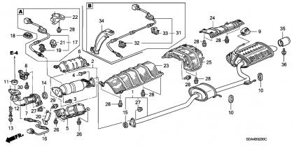

It's the rear sensor, #31 in the picture. Picture is 4-door, but 2-door is almost the same.
The wire disappears through the floorpan of the car, and you have to unplug it underneath the passenger seat. Rubber grommet at the floor of the car can be seen in the picture, & *should* be large enough to pull the plug down through the hole.
