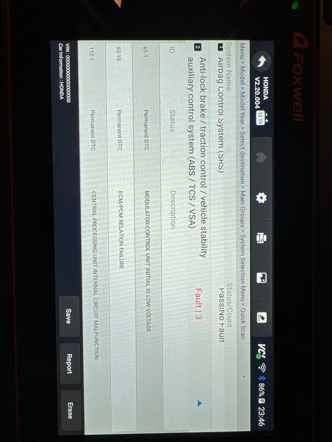

good afternoon! I have a 2006 Honda Accord that died on me on the freeway. there is the green key blinking on the dash, and the fuel pump is not kicking on when I turn the key over. when I hook up my scan tool. I do get lights coming on. but only the SRS and ABS areas are showing up.

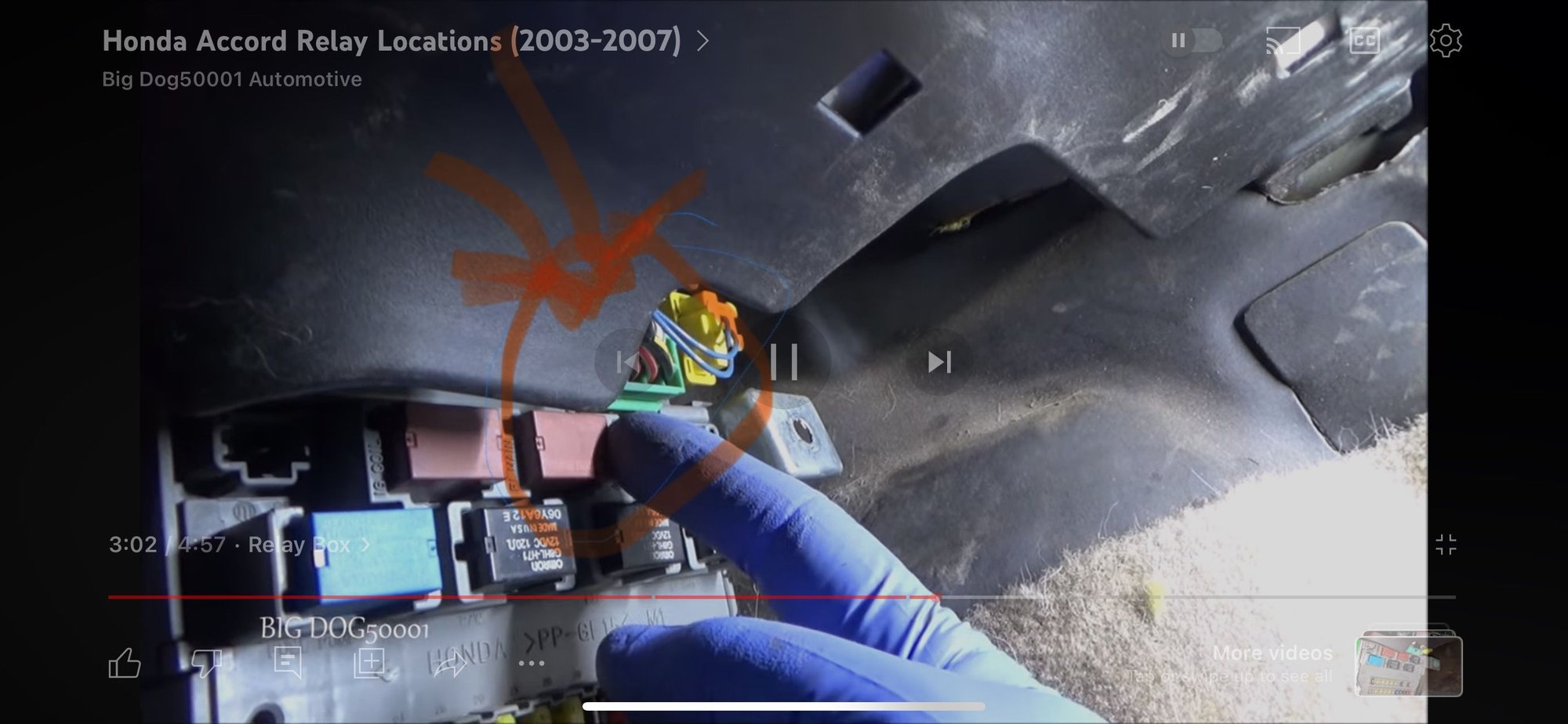

I did check with a multimeter and I am not getting power to the connections under the orange relay PSM1, which I believe it is listed as. I believe it all stemmed from power to that one relay. the second relay under the kickpanel at the driver's feet next to the coil pack relay

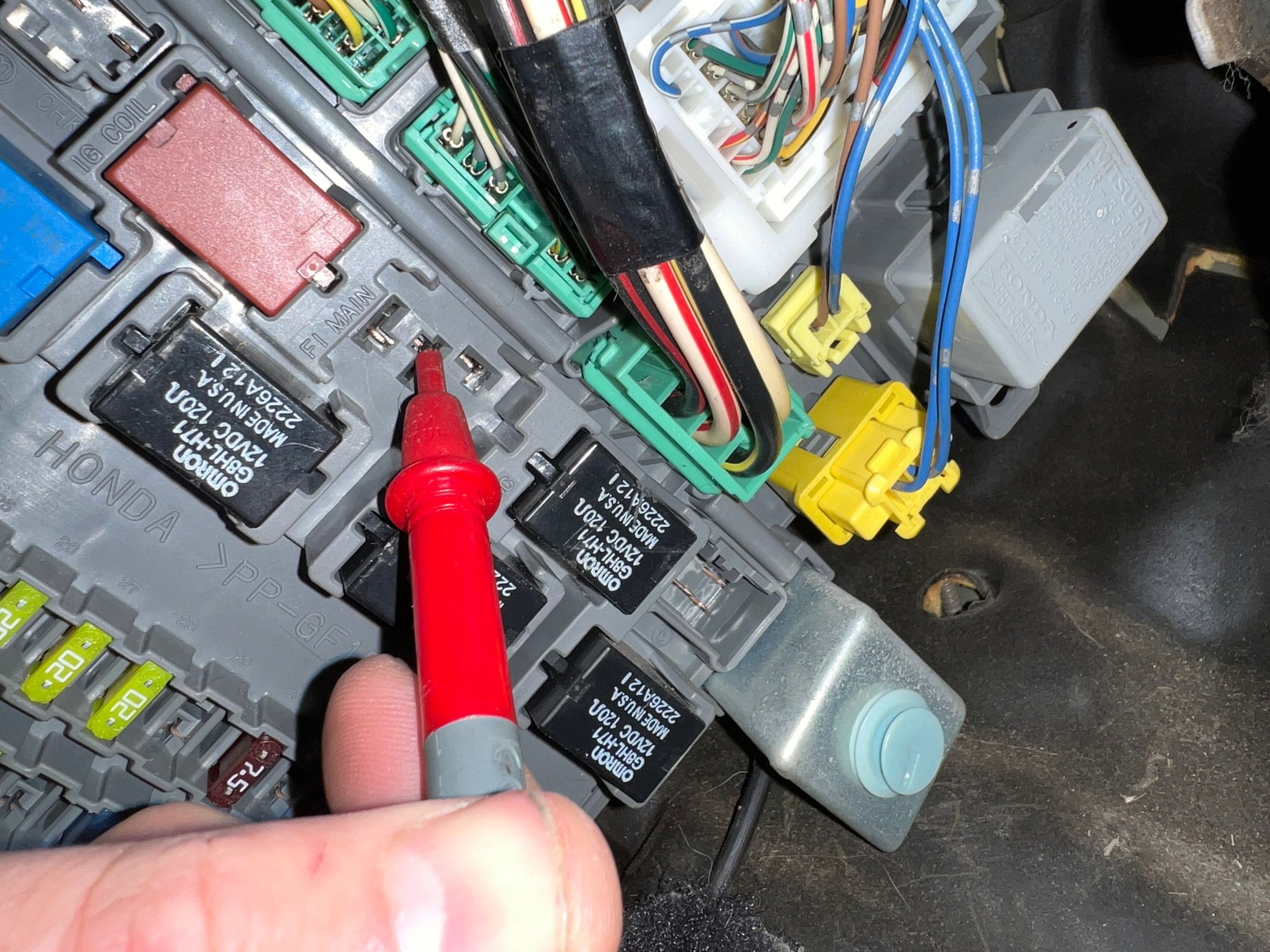

I'm sorry of I was not clear. It is not a fuse that is not getting power it is The Orange relay. Then I pull The relay and check the female cavities. I'm getting nothing

That is the PGM-FI1 relay. It sends power to the fuel pump relay and to a bunch of other items.

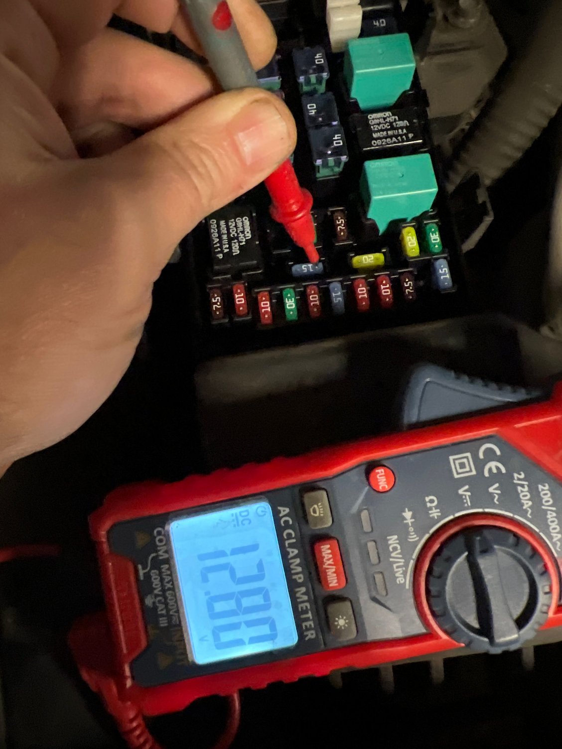

That relay gets power from the under hood fuse box #8 15 amp FI ECU fuse. You should check for power on both top tabs of that fuse to make sure it is not blown.

12.8v on both sides of That fuse.
When grounding out to a bolt, all of the connections get 12v except the one in this picture

Most relays will have 2 pins with power and 2 that have no power and are permanently or switched to ground. On that particular relay, 3 pins will have 12V and one will not. The pin without 12V is the power output of the relay when the relay is turned on. So your testing is normal.
Since the fuel pump is not turning on, I'd probably remove the access panel in the trunk and test for power at the fuel pump. Pin 5 yel/grn should get power when you turn the key to the II position for a few seconds when the car primes the fuel pump. Pin 4 is the ground wire for the fuel pump and should have ~zero resistance to ground. See pic below.
