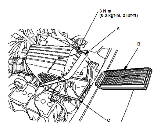

An air filter with a partially torn or pinched gasket may also cause drivability issue; but, may not show any MIL, etc. unless the Mass Air Flow (MAF) got too dirty due to it. You can check the air filter yourself to see if the rubber gasket on the filter is pinched.
