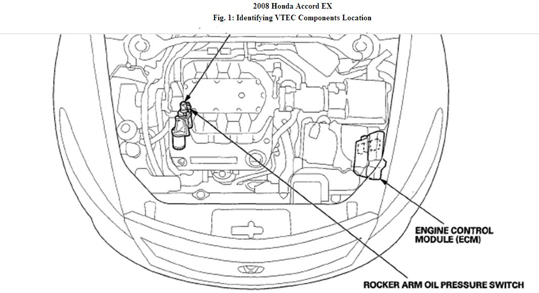

i need to change my v6 vtec solenoid sensor but i cannot locate it. can anyone help me as to where ti is located. i know its on the passenger side at the rear of the head but i still canot locate it. does anyone have a short video to show where it is?

I can't recall the code but I'm sure it's the vtec solenoid. I'm jus having trouble locating it under the hood

What trim level is your V6? Coupe with M/T or something else? For V6 models, only V6 coupe with M/T suppose to have VTEC. The solenoid is located on the oil filter housing (what the oil filter attaches to).
Also, posting the code will be better, as sometimes it came mean something else.
Old May 16, 2015 | 10:02 AM
Once again, beat me to it...here is a pic to go with Redbull's description.

Thanks guys. Very helpful
