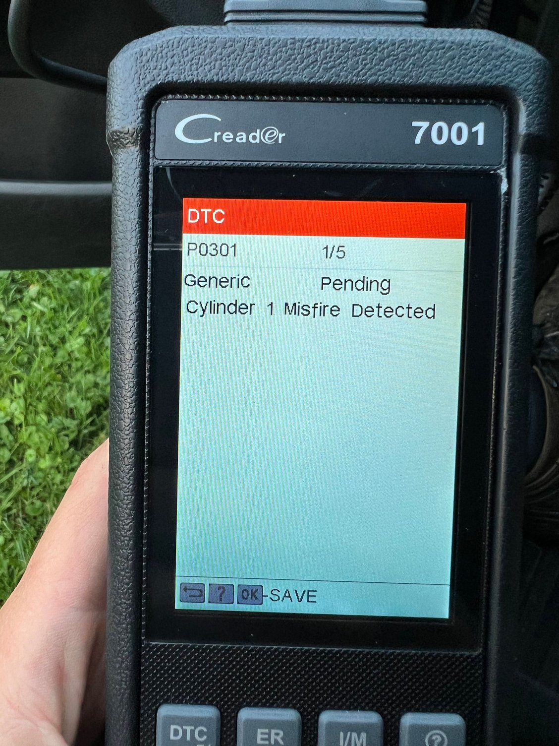

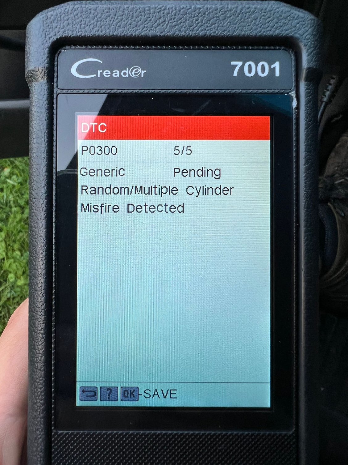

I have a check engine light for all four cylinder misfires and a generic misfire code (P0300-P0305)
however the CEL doesn’t start immediately, the car runs perfect for around 45 -100 seconds after startup, then engine light comes on while using any throttle at all and goes away when the car is at idle.

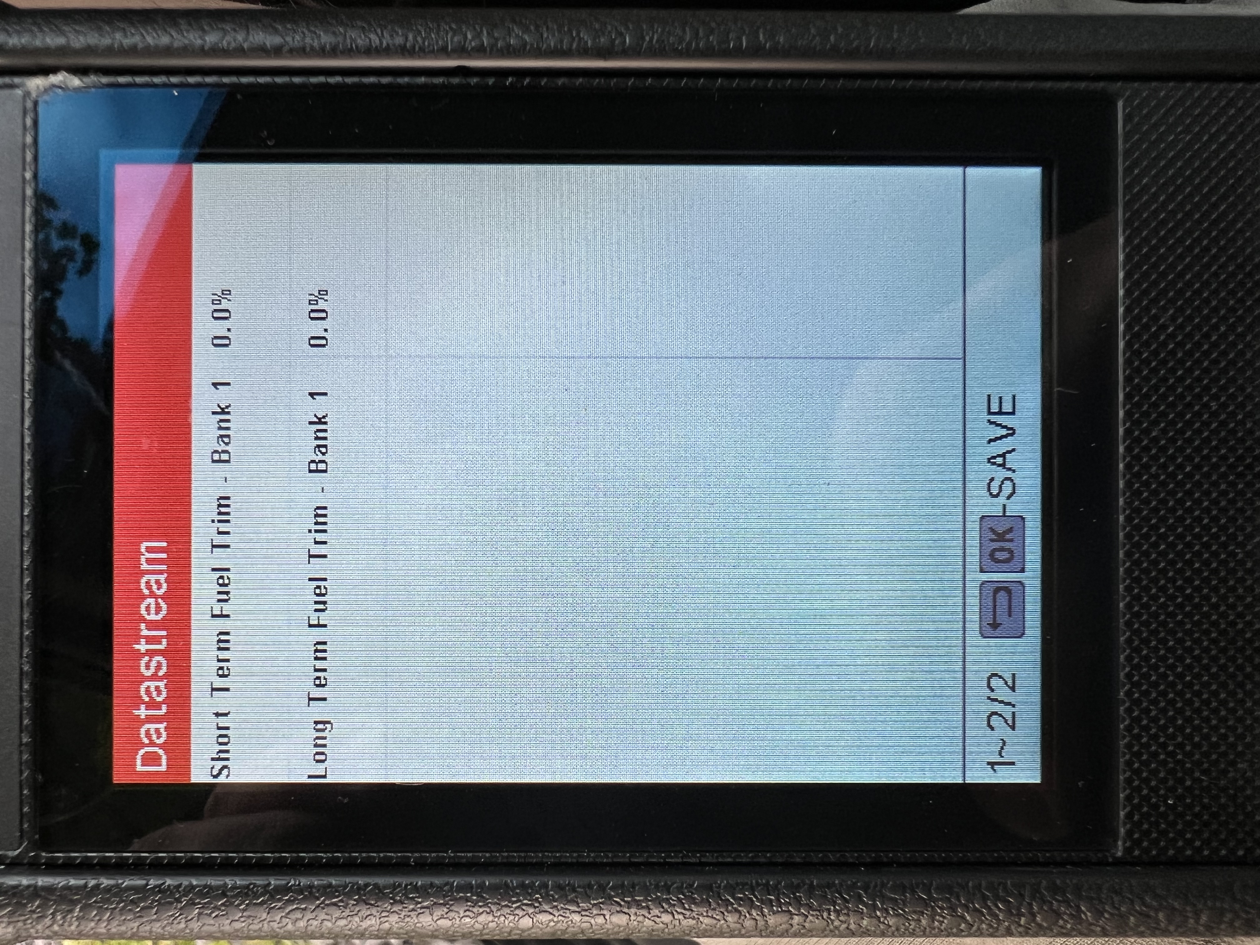

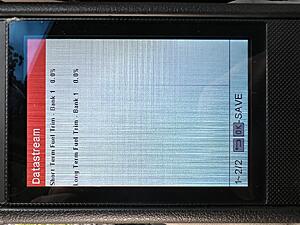

So when I restart the car before the engine light comes on the short term fuel trim is between -10 / -18 as soon as the engine light comes on it drops to 0 and never moves,
Also the long term fuel trim never moved from 0
Attached Thumbnails 2011 accord I4 misfires help pls-0256abbe-a478-4a51-a2aa-ed072d30cab2.jpeg
Old Aug 26, 2022 | 05:03 PM
Posts: 16,334
The total fuel trim is the sum of the 2 numbers, so your PCM is detecting a rich condition and injecting less fuel. What does the mass air flow sensor show at idle before the CEL turn on?
