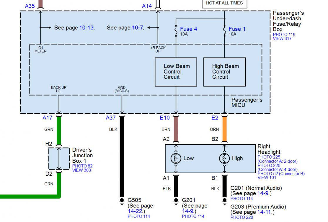

The right high beam control circuit is part of the passenger side multiplex integrated control unit (micu). There may be a short in a component inside the micu (the micu is incorporated as part of the fuse box).

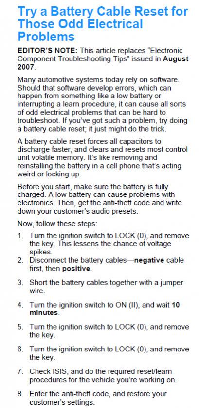

Try a battery cable reset to see if it changes anything with the micu. Disconnect the negative cable (disconnect negative first) and then positive cable. Then connect them together with a jumper wire for 15 minutes. -- Do not touch the battery terminals. You'll need the radio's anti-theft code afterward. See the attached Honda Service News excerpt, which has a variation of the battery cable reset which requires turning the ignition on and off; but, only requires 10 minutes. The 15 minute reset doesn't require turning the ignition ON, etc.
