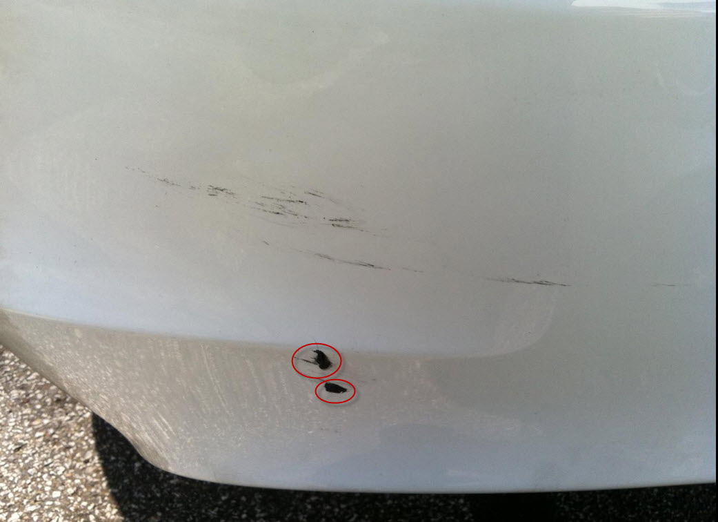

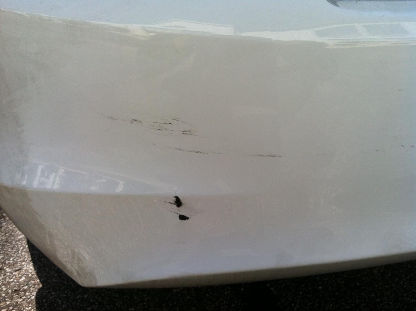

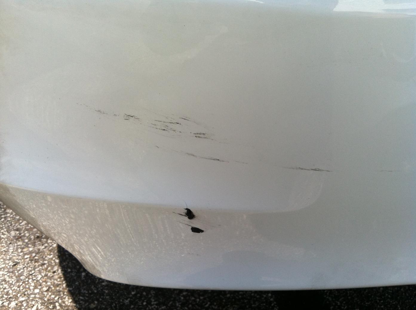

I have a 2012 Honda Accord sedan, that have the scratches listed in the attachment. How much do you think this would cost to repair? Maaco has quoted me for 286. Does this seem accurate? What would you do if your in this position?

That's kind of minor. Most of those lighter, smaller scratches should buff right out. The two larger spots could be made to look better with a little primer/filler and then some Honda Taffeta White touch-up paint.
I would use some Quixx Paint Scratch Remover. It really works and is sold at Walmart, Advanced Auto, etc. I use it on my own car.
If it really bothers you after that, then get the whole bumper repainted. However, Maaco paint jobs usually aren't the best. There are other body shops that will repaint it for about what Maaco is quoting you.
