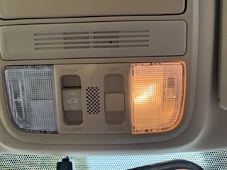

The driver side interior overhead light does not come on when I open the doors. The passenger side works fine. I have replaced the small push buton switches swithces on both sides, but no change. Checked all interior light fuses and they are fine.. I push the driver side off/on switch and the light works. What am I missing? Yes I have moved the switch from door to off na back to door.

Does the driver's door have a courtesy light when you open it and does it work properly?
If you have a volt meter or test light, remove and unplug the door switch, then test for 12V on the wire. Use a bare metal like where the seat bolts to the floor as the ground. If the swtich has two wires (not familiar with the 2012 setup), then test the non-black wire (brown?) for voltage.
