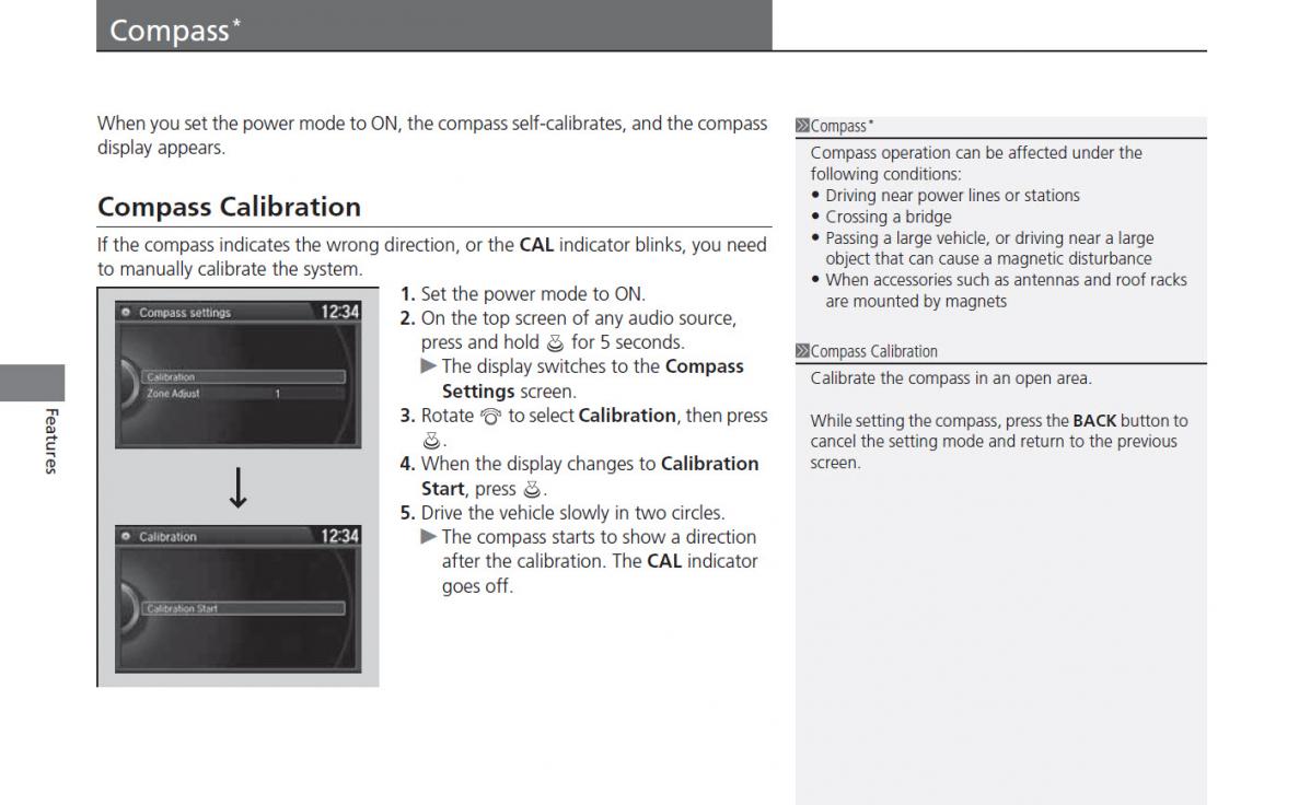

I tried calibrating as per the manual, but everytime I select "Calibrate compass" the thing just kicks out to whatever screen I was at before.

The buttons and displays varies based on models; however, try the following:
Turn ignition to ON (II). Models with the smart entry system have an ENGINE START/STOP button instead of an ignition switch.
Turn radio off so you don't lose the screen while you are adjusting it.

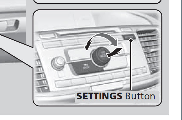

Push and HOLD the SETTINGS button for at least 5 seconds. Depending on the model (one display screen, two display screens,or navigation); the Settings button is either to the right of the Selector ****, or above the Selector ****. The display screen will switch to the Compass Setting screen.
Rotate the Selector **** to select Zone Adjust first before you calibrate. Press the Selector ****. Rotate the Selector **** to select the zone number of your area (see zone map in your owner's manual).
Rotate the Selector **** to Calibration, then press the Selector ****.
When the display changes to Calibration Start, press the Selector ****, then drive car slowly in two circles.

Tried that =/ The dealer was able to replicate the afforementioned actions on another accord in the lot, just wont work on mine...

COMPASS PROBLEM - I also am not able to observe the compass on my 4-day-old Accord Coupe EX-L V6. I have tried the suggestion above (by RedBull) but having tried to hold down the SETTINGS button (just above the Selector know) for 5+ seconds many times (and under many variations) I am not able to generated any manner of display having to do with the compass. From your experience, does this look like it is going to be a major problem ??? (I am a brand new subscriber to this site, also having joined to seek your help.). Thanks JJK
