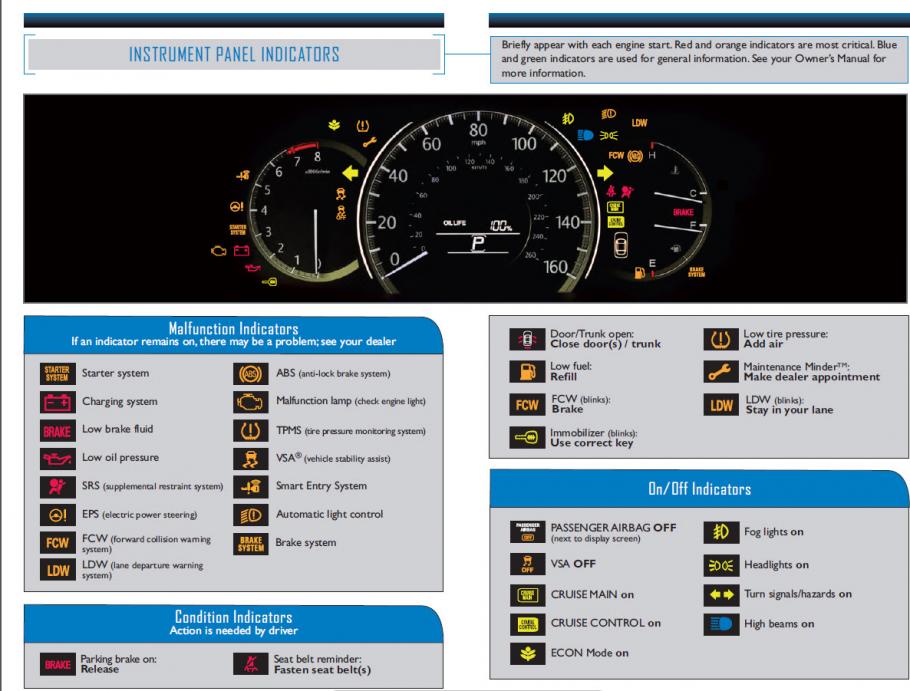

Can anyone tell me if you have a passenger air bag light "ON" illuminated while driving. Many thanks.
Old Apr 20, 2014 | 12:55 PM
Posts: 7,101
Sounds like you're referring to the passenger airbag OFF indicator. This indicator is generally not lit when driving, unless there is someone or an object (object would have to weigh enough to be detected by the weight sensor) that is less than 65 pounds in the front passenger seat.
Attached Thumbnails 2013 Accord EXL V6 Passanger air bag light-passenger-airbag-off-indicator.jpg   2013 Accord EXL V6 Passanger air bag light-instrument-panel-indicators.jpg
Old Apr 22, 2014 | 09:41 PM
MIA11's Avatar
Joined: Apr 2014
With a passenger in the passenger seat will the off light now show "ON"?
