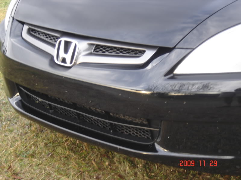

IMO most cars don't have enough protection for the condensers. I installed this expanded metal to stop most rocks from getting in (the expanded metal behind the upper grill is just for looks/continuity).

The 2013-14 Accords already has something similar to give some protection; but, it won't protect against all rocks; so, some can still get through and damage the condenser.
Several years ago, due to a class action lawsuit settlement, Honda did make a retro-fit metal condenser protector for the Honda Odyssey that was riveted to the lower front of the condenser.
