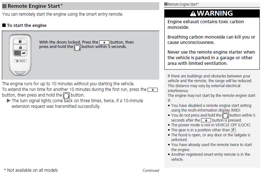

Wondering if any one who has a 2016 Honda Accord has or has not had trouble with the remote starter. I have had me car for a couple of months now and the remote starter starts the car for 10 minutes as the manual indicates but the manual also indicates that by going through the same procedure while it is running, it will extend another 10 minutes - a total of 10. I have tried everything to get the extra 10. Have gone back to the dealer and they keep suggesting things that don't work.

Thanks for the reply..... The manual actually says that it can be extended. The other problem is that when it stops, I cannot remote start it again. The lights flash but it doesn't start.

I went and looked at the manual for the 16 Pilot and see that it does say that it can be extended.....never tried, something to maybe try this weekend.
