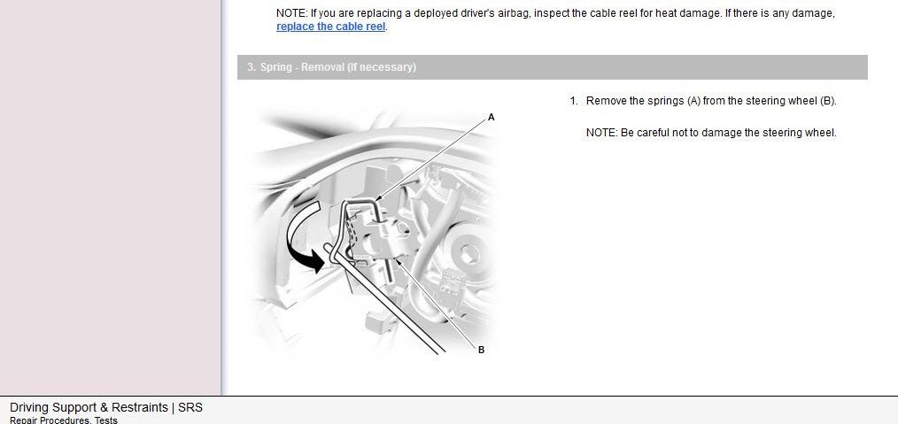

Just for informational purposes, the following entails replacing the Audio Remote/HFL Switch Control.
Both battery terminals are recommended to be disconnected from the battery for at least 3 minutes before the start of any work, due to the driver's airbag. Although the connectors to the airbag can be easily disconnected if done properly, if the connectors are forced and broken, it requires replacement of the whole harness.
For the lower garnish piece (#2), if the steering wheel is heated, an electrical harness connector needs to be disconnected.
When separating the upper garnish piece (#3) from the control switch (#4), there are tabs and and slots that must be carefully separated. Reassembly is in reverse order and pieces should be carefully aligned.
