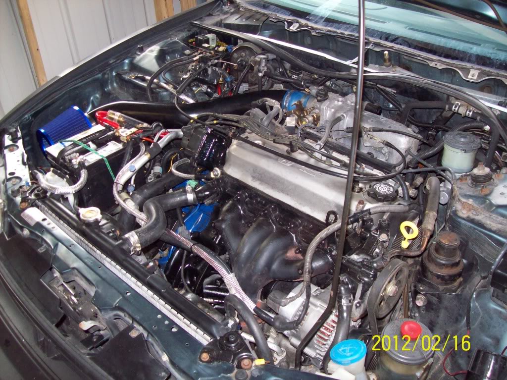

Here it is with everything back where it is supposed to go.
I put in the 5 speed ECU yesterday and now I no longer have a Christmas Tree display on the cluster.
I had a weird no start issue briefly yesterday - it sounded like it was out of time. I ended up spraying a bit of light oil in the intake and it started right up. I test drove it for a while after that starting and stopping it a few times with no other problems.
Now I do have a potential problem I will look into it more today.
For some reason 1 of my cooling fans always comes on for a few mins after I turn the car off. It has done that since I got the car. Only recently here on the board did I learn that the fan is only supposed to come on if the car was running hot.
Well yesterday after the car had been off for for at least 1/2 an hour the fan was still running. I pulled the power plug going to it.
I will see how it runs today - hopefully everything will work fine today.
Yes I know the paint came out very poorly on the dist. I tool the dist off yesterday to change the O-Ring and wanted to throw a coat of paint on it. So I hit it real good with degreasor, scrubbed it with steel wool, hit it with 400 grit paper, rinsed it with water and let it dry. I hit it with an old can of Engine Paint in red and it just bubbled up real bad. I thought it might have been that the paint was a few years old. So I removed the paint cleaned it again and hit it with the Blue Engine paint that lays real nice on everything I used it on. Same thing happened. By now I was getting frustrated and wanted the Dist back on so I could test drive the car so I covered it in the cheap black paint. I guess one day I will take it off and redo it, but hey I have to keep reminding me that this is no show car, I am the only one who ever looks under the hood anyway.
