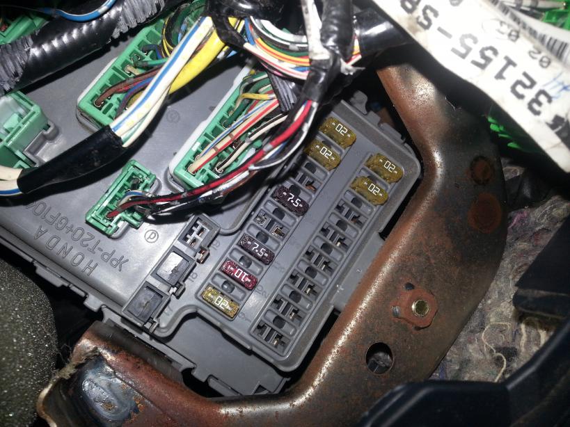

Power Door Locks = fuse # 12 (20A fuse, yellow in color)
fuse block on pass side of dash - MPU "piggybacked" to the fuse block
fuse simply is fried as I move the new one into place - literally arcs as the fuse blades approach the seating/mounting position on the fuse block - fuse never even gets anywhere near started, let alone fully seated
PDL is the only thing listed on the access panel sticker listing fuses/position and what component(s) are served.
I hope that pics are of some help/clarity
Thanks....
