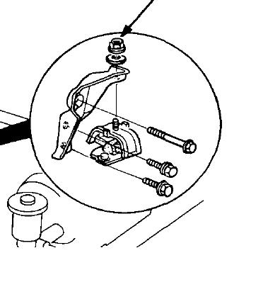

ok so i found the rear motor mount and it is def broken how do i go about removing that one the manual is pretty confusing
Old May 20, 2012 | 07:49 AM
  #27
Not too bad of a job.
The bracket that bolts to the trans has to come off, three bolts hold it on, a long extension and a swivel socket will be your friend. There are the two bolts holding the mount to the subframe that are not shown in this pic.

ok that sounds safer i was told to just loosen then jack the motor up and slide the mount out as for the torque like you im poor and very limited on tools
Old May 20, 2012 | 10:54 PM
  #29
siege's Avatar
Joined: May 2012
Posts: 20
all i have is a basic ratchet and a very short extension
Old May 21, 2012 | 07:10 PM
  #30
You might be able to manage. Space it tight under there, you might make a "test" run, meaning jack the car up (safety !) and be sure you can get to the bolts and one nut.
The long extension - three or four put together - alow you to get the ratchet to a place you can get some torque on it. So I understand not having alot of money laying around......harbor freight or some place like that might sell a 3 piece extension set for ~$10. From there a simple swivel might work....I have the swivel sockets that make things even easier. My bet, even if you spend $25~30 on the tools, that will be cheaper than paying some one and you get to keep the tools for the "next" time something comes along.
