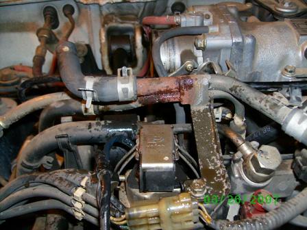

Default another suprise
I cleaned the TB and started it up and the small metal tube below the valve cove tube has a pinhole leak that was spurting antifreeze out of it (see pic). the valve tube was puting out a lot of smoke at the beginning but after I shut it down for the first pic I wanted another one of the leak in action, there was no smoke coming out of the valve tube. is that of any significance? the engine was shut down for less than a few minutes.

Old Jun 11, 2010 | 06:32 PM
Well my friend we might be in for bigger issues. I'm hoping for an easy answer...
The two tubes are close together, best is hope the coolant part in coming into the oil part. What does the oil, on dipstick, look like? Is the coolant level where it needs to be and no aair? As a temp try, bypass the metal tube coolant part. A piece of like 3/8 hose, not through the metal "connector".
From there we are down to the "leak down" test you mentioned before...sorry I wish I had better advise/news....ps I'm having to go on memory as the boy isn't home today for me to look at his 88 LXI.
Old Jun 11, 2010 | 07:58 PM
caliass's Avatar
Joined: Apr 2008
Posts: 18
Thanks poorman,
I called my local honda guy to order that tube thing and he said it has been discontinued. Needless to say I have a fabrication job on my hands, just like you suggested. I am going to bypass both of those, probably using the 3/8" tube for the valve and maybe some brake line for the coolant. I will post what happens no matter good or bad. if bad, I concur its time to get the leakdown tester. Am I being too cheap by getting it from harbor freight?
