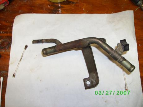

Alright pretty excited here, ran some qtips throught the coolant portion and oil deposits came out. I am wondering if the fact that the pcv valve thing masked this. Going to stillbypass with rubber tubing and thinking that a coolant flush is in order.any ways here is a pic of the tubes and the qtips. I hope this helps evryone,

Keep us updated. I'm really reaching with the tubes "leaking" into each other. The compression/leak down will tell the story. I'd hold off on the flush until the answer is known.
