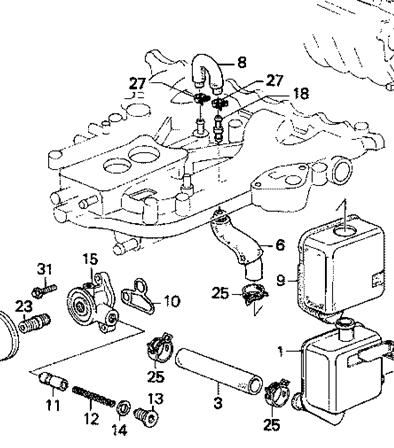

That "tube" is a breather tube - at the top where it "pokes" thru the intake is the PCV. That hose, I know I have....brand new in my hand. Now I'm not sure if it fits the carb or FI models - 11856-PH2-000. Strange the parts I have under my chair . The date on the invoice is from '11 - so I'm not sure which 3rd gen I got it for. Usually what happens, IMO, is that when you go to change the PCV, the hose is so brittle that it breaks into pieces.

You'll have to get the PCV breather tube from the dealer, online dealers have them ~$15. I posted the PN of the one I have and it looks like it fits the "carb" models - which I don't own one of those anymore - and this time I know I have the part, it is right here to my left.
The tube goes from the oil pan to and "thru" the intake manifold - the PCV sits in the top of it where it "pokes" thru the intake manifold.
See #6 in the pic.
Attached Thumbnails 89 accord update: FUN-3rd-gen-carb-pcv-breather-tube.jpg

Posts: 70
What is #3 in the pic? I think thats what I noticed .a horizontal tube not poking up
Old May 23, 2014 | 04:42 PM
That is another "tube" - vent. Not sure if that is still available from the dealer or not. You might be able to get a piece of hose from a parts store and "make it work" - as my memory tells me the OE hose had a taper to it - meaning one end is X size and the other is Y.
