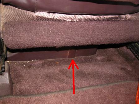

Codes store in the ECU under the seat (at least until you unhook the battery or pull the underhood fuse). So look at the ECU for any codes (it has a red led light that will flash the codes).
This pic is from behind the drivers seat....I move the seat all the way forward for better view. The arrow is pointing the "tab" that has to be opened to view the led light - pull it open from the top.
