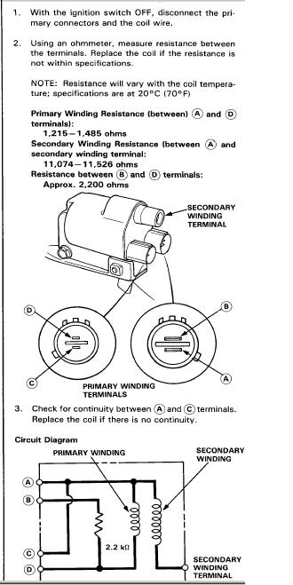

Just my opinion, testing needed. The ICM or coil is going out (lean towards the coil), once hot there is no more "signal" or "spark" coming to/from it....If you were close by, I have a spare coil in the garage,,,,somewhere????
Round cap with no flat side is a Hitachi dist.....you'll need to know this if you get a new cap/rotor or testing of the ICM and that.

Will get back to the car tomorrow...how do I edit a post? Do you have a diagram as to where the Ignition control module is and the coil. If you have a spare....can you send it to me? This site is great and you are very helpful!! D

At the bottom of the post there should be an "edit" button.
For the ICM and coil testing....hope you go that volt meter?
At the top of this section there is a "sticky" - Common DIY Threads. In that there is a link to a manual you can download.
You might have to do these tests when the issue is present....meaning cold everything might test fine......once it runs for "some period" of time it dies again, do the tests again once that happens.
Sorry, I still have three of these in the driveway. What I was saying is if you were close enough (short driving distance) I would let you "borrow" it to see if the issue goes away...if so then we could talk price or you could buy a new one as this one is used (~150K miles on it, or so). Not sure if you have any junk yards close by, they might be a good place since you are trying to sell this.
