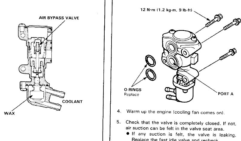

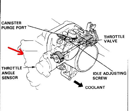

He wakes up....sorry. FITV is just behind the TPS (aka Throttle Angle sensor in this gen).....just in front of the TPS there is another coolant nipple.
So I think you are seeing the TPS with the wires - no coolant would be coming from it. However just behind that or more towards the center of the firewall is the FITV.
Check those small coolant lines to the FITV and the TB to be sure one does't have a split in it and spitting coolant onto the TPS.

If need be let me know and I can take a "real" picture of mine this Saturday - those pic's are from my service manual I have for my 89 Accord. It is due to be started and ran for a few minutes anyway.

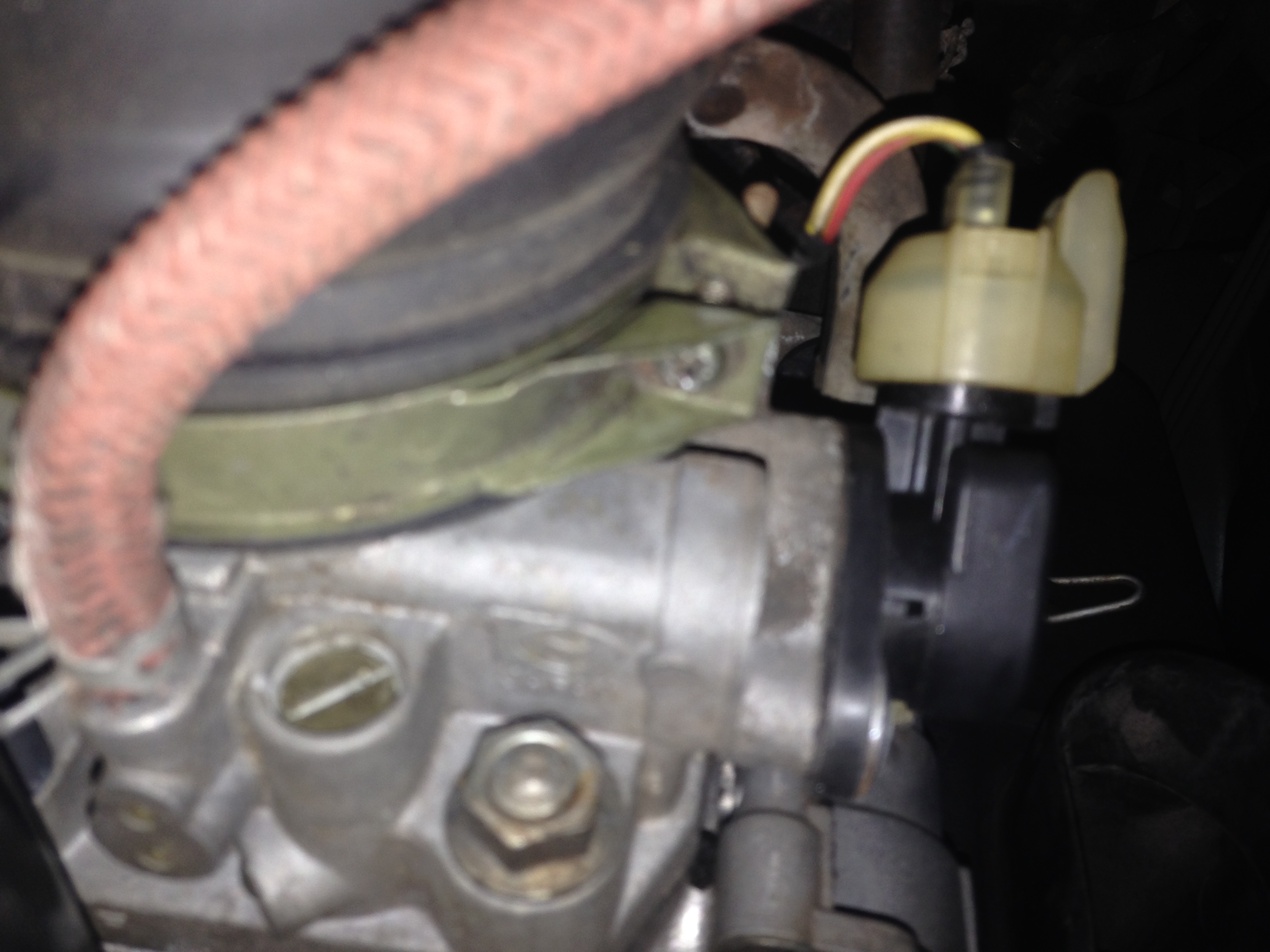

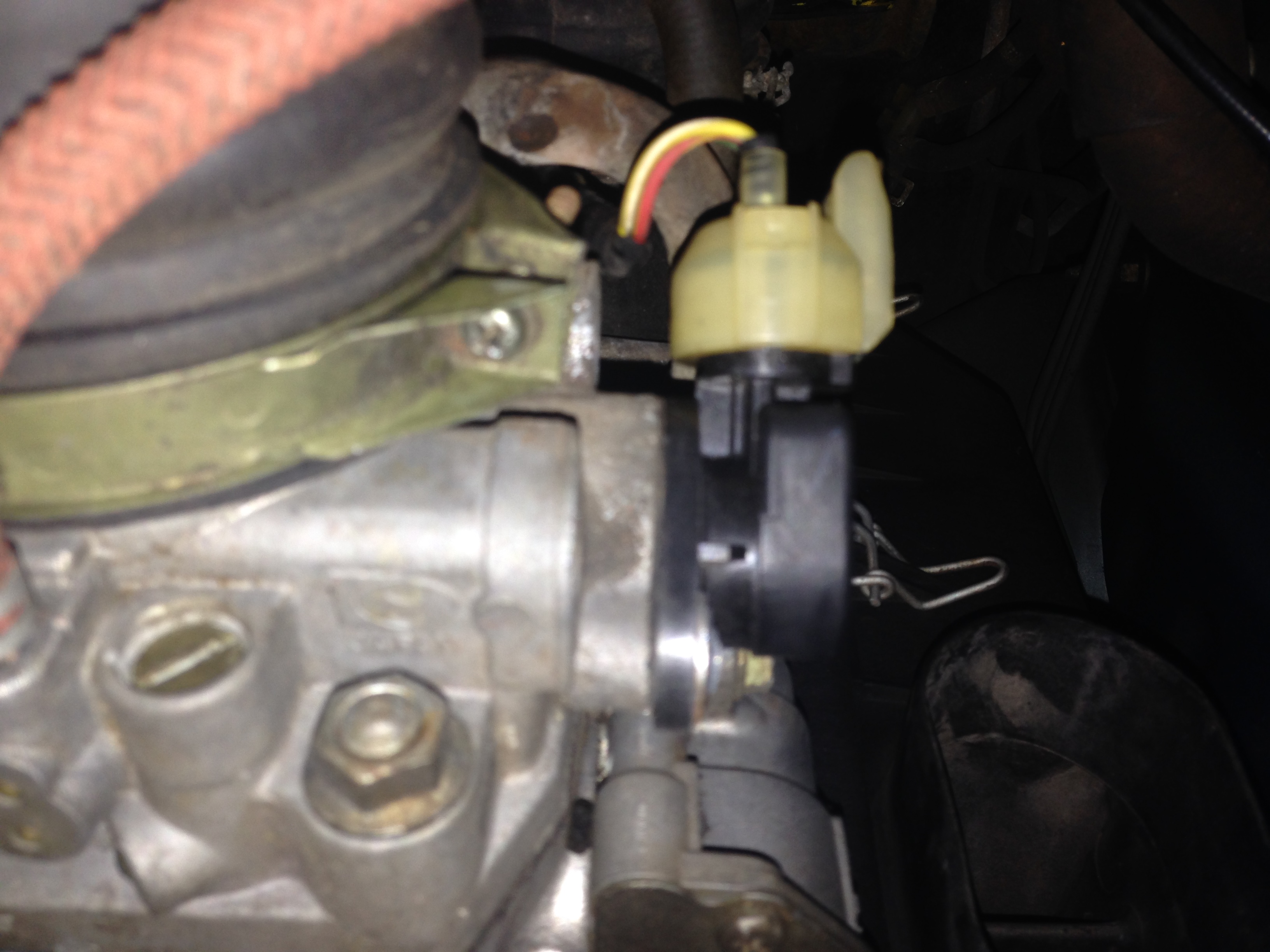

i have 3 pictures of the part i was talking about.could someone tell me how to install them on here.Thanks

here is 2 pictures of the part i was talking about .hope this helps.the part is towards the firewall .Thanks
