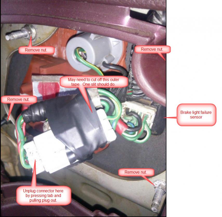

It may be the brake light failure sensor being referred to. There are two light failure sensors in the trunk area; the left sensor (usually brown) is for the left outer and inner brake lights, while the right sensor (usually black) is for the right outer and inner brake lights, and high mount brake light.
The brake light failure sensors are use to help indicate if a bulb burnt out, and power has to go through it to the brake light bulbs. The sensor components may go bad or solder joints crack with age/use; where power no longer goes through relay coils inside the sensor to the brake light bulb.
You would have to remove the taillight assembly by removing the nuts at the perimeter of the taillight assembly. Disconnect the bulb connectors and sensor connector first.
After the taillight is out, you can access the two mount screws for the sensor.

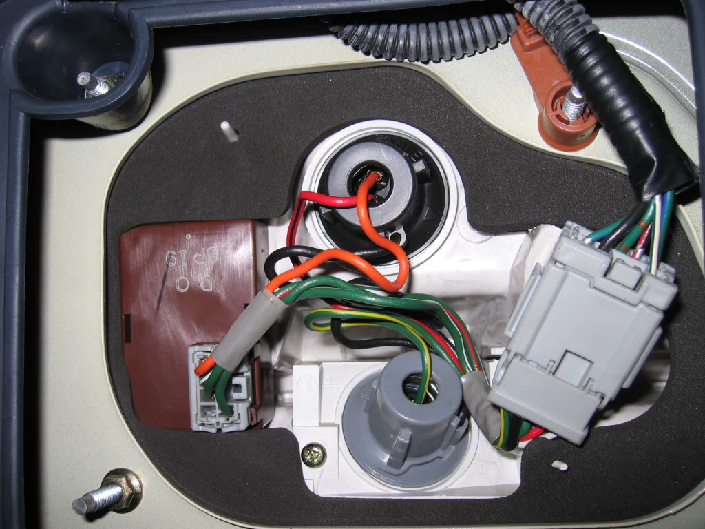

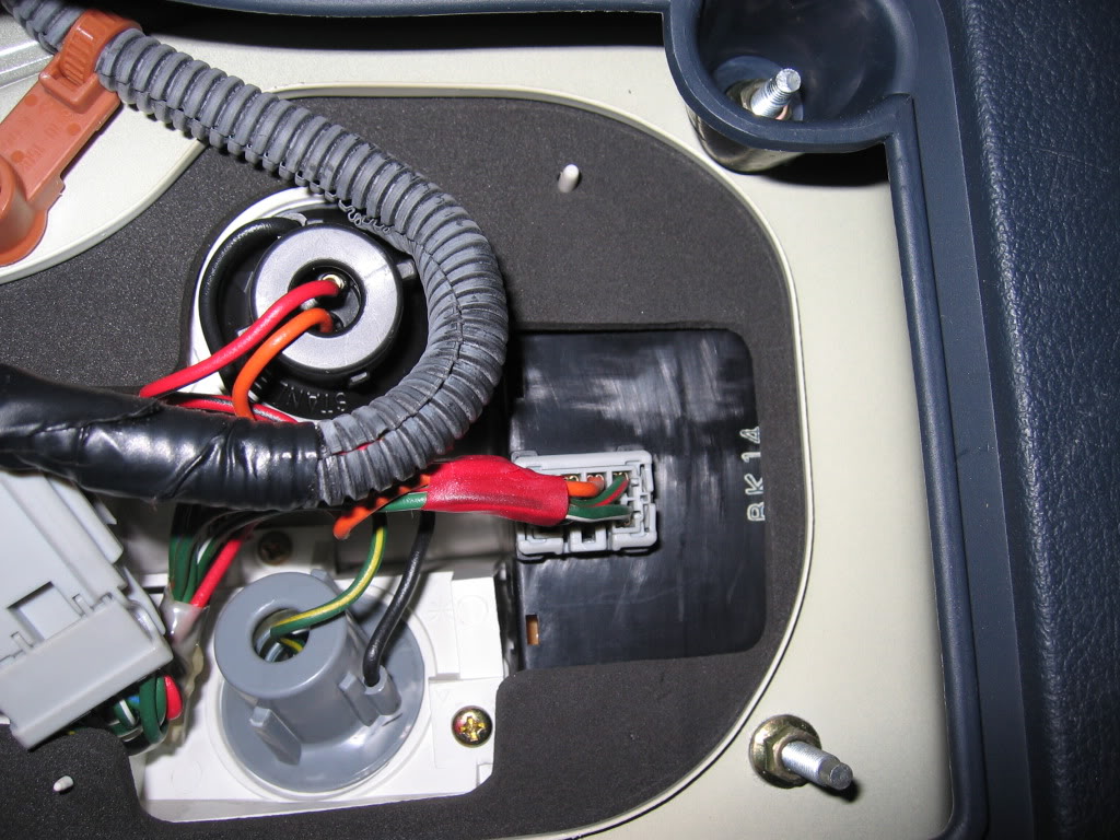

Here are a few more pictures I found to help understand removing the taillight assembly. If you unplug that one connector, you don't have to disconnect the bulb connectors and the connector to the sensor before removing.
It should be 4 nuts holding on the tail light.
You'll have to gently pry off the the plastic harness clip from one of the corners that cover a nut.

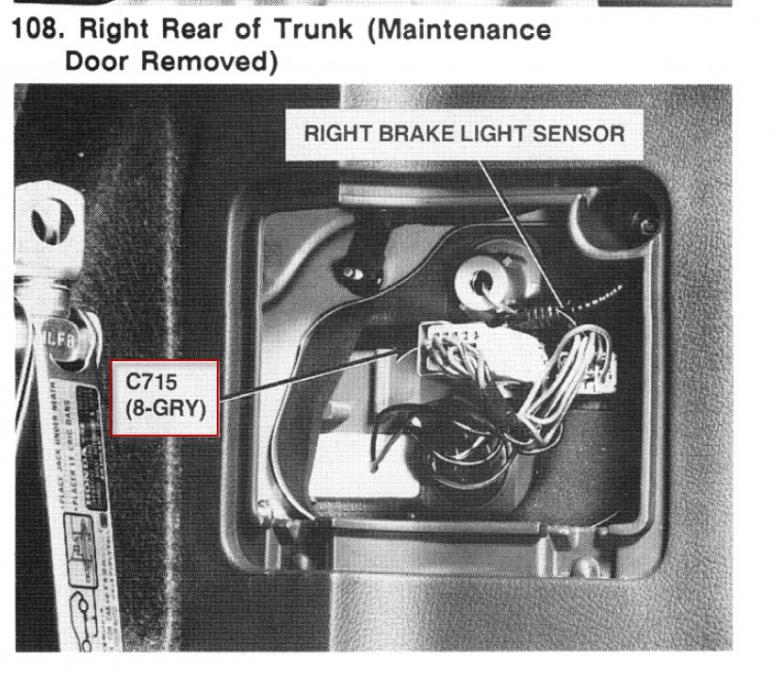

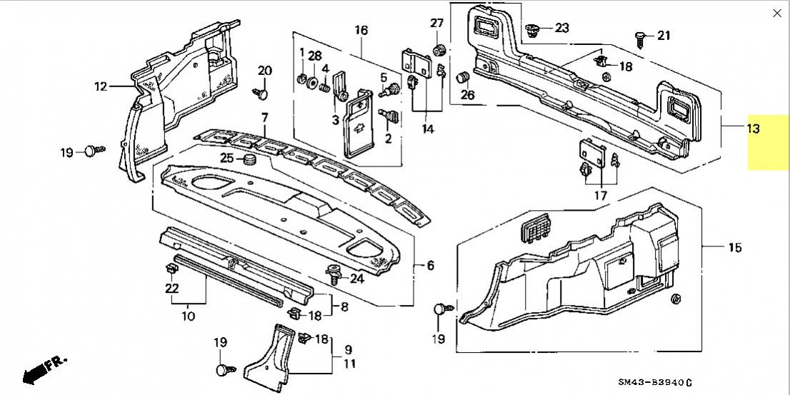

On your 1990 Accord, you'll probably have to remove the plastic trunk liner panel to access some of the taillight assembly mounting nuts.
The plastic liner is usually held on with clips. Looks like there are possibly at least two plastic clips to pry out first. Then pry/pull the whole rear plastic panel liner off (the non-visible clips should come off with the panel).

Okay, no need to remove the whole trunk liner panel.
You can unplug that one connector first. Probably have to cut the outer electrical tape, not all the tape, to free the harness wiring. (See image.)
Then remove the mount nuts. They should not be too difficult to loosen.
