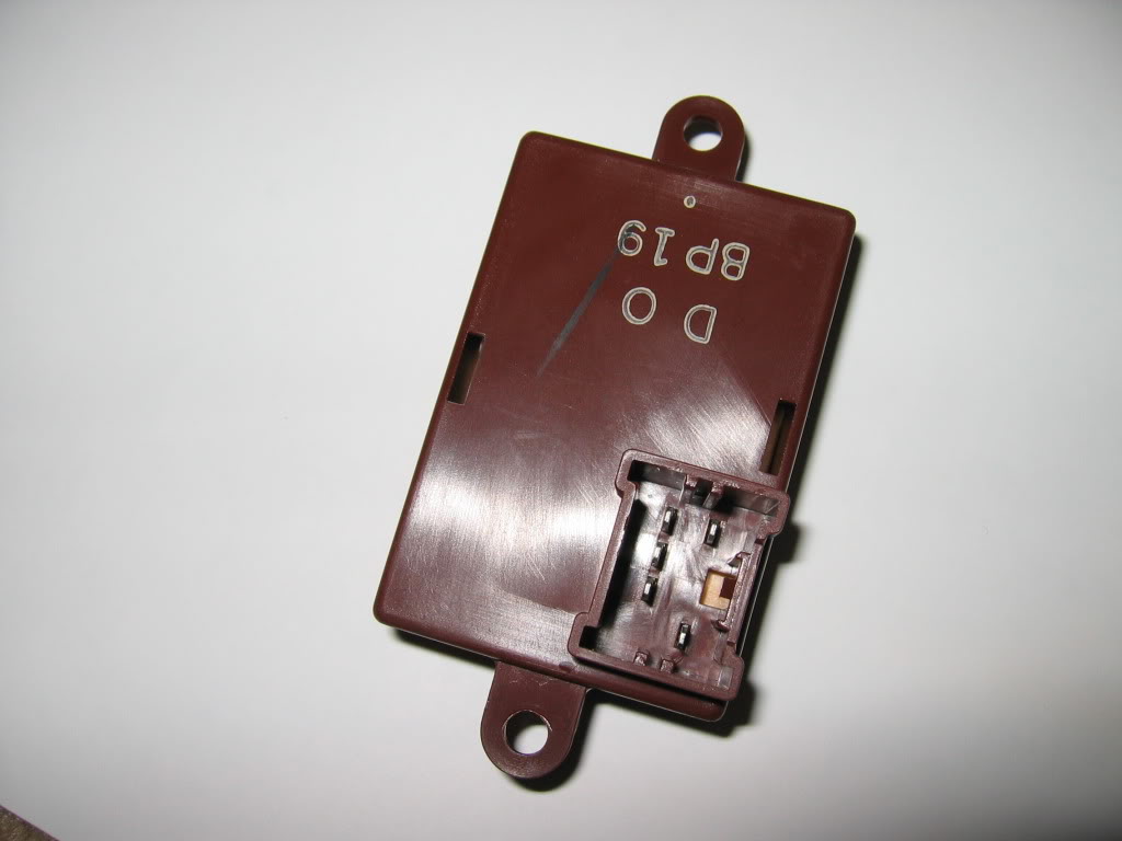

That is just the taillight lense, that would not be the part.
Right side would be Honda Part Number: 37540-SM4-A01. It is the little box like in the previous images I posted.
Edit: My mistake, your PM said right side (passenger side).

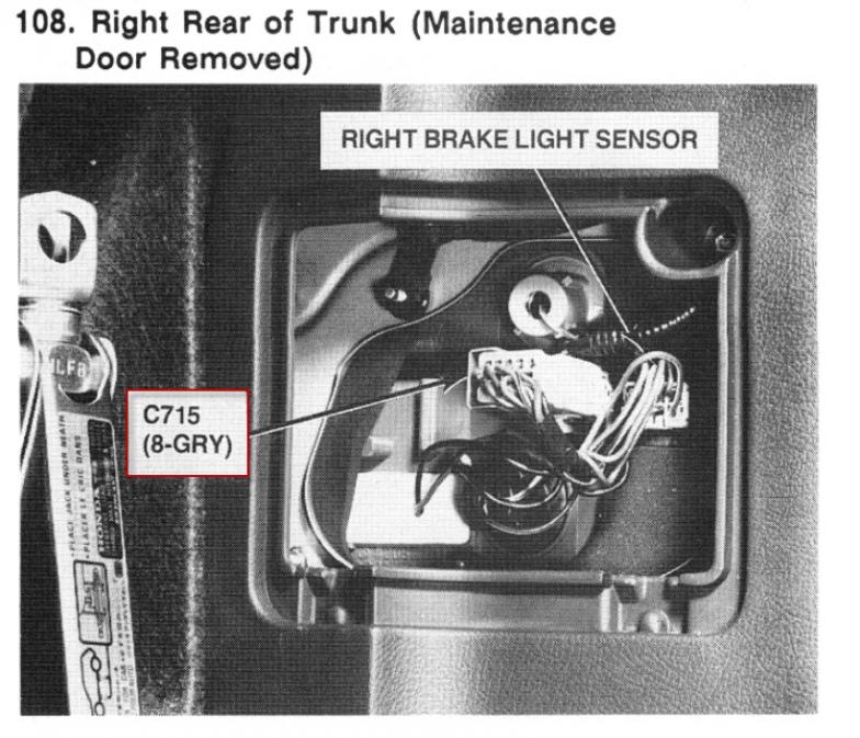

Here is a test if you want to try. Verify the wire colors first.
Unplug the 8-gray connector (connector C715) shown in the attached image. With a wire or small paper clip, jump the 8P connector female terminal cavity (where the Grn/Wht wire is) to the female terminal cavity (with the Grn/Yel wire). The Grn/Wht wire is a wire with green insulation and a white stripe running through it. Depress the brake pedal; does the high mount brake light work?
You can then jump the Grn/Wht wire female terminal cavity to the Grn/Red wire female terminal cavity. Then depress the brake pedal, does the right inner brake light work?
If they work this way, you probably have a faulty brake light failure sensor.
