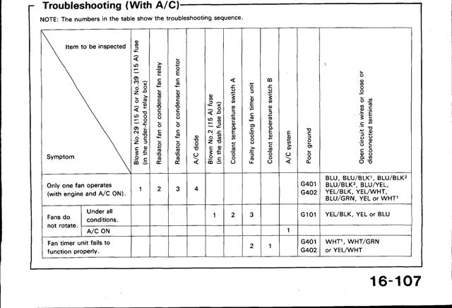

Okay. I jumped the switch on the thermostate housing with the key on and both fans came on. Is that thermo switch A? I had never tested that one before, I was just testing the one on the cylinder head and on the pipe in front of the engine. I thought those were the ones to test for.
So what does that mean? Am I good?
According to the manual the one and only symptom of fans not coming on with AC on is that the AC is malufunctioning,
How to fix the AC now?

AC system is good.
Fan "circuit is good". Looking like thermo a is bad....the switch in/on the t-stat housing where the lower hose connects.
If you turn the engine on with everything hooked back up, let it run and watch the temp gauge and listen for the fans. If the temp gauge gets to just above 1/2 and the fans do not come on....Replace thermo a.
If you had a temp reader, thermo a should make the fans come on when it gets to ~196.
