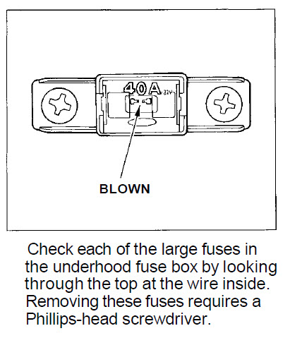

Check the large fuses in the under hood fuse box.
Fuse no. 15 (80A), alternator, power distribution (main fuse) is probably blown. Also take a look at fuse no. 19 (50A), ignition switch (BAT).
To replace the large fuse requires a Philips head screw driver.
If fuse(s) are not blown, check the ground (at battery and chassis, etc.) and power wires and connections. Look at the condition of the wires to see if they are frayed or corroded at the core.
Attached Thumbnails 91 Accord Dead Battery and its new!-under-hood-fuse-box.jpg   91 Accord Dead Battery and its new!-checking-large-fuse.jpg
