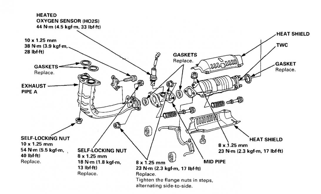

I'm putting new gaskets in my mid pipe and the gaskets I got are tapered at one end. Idk which way they go in the exhaust. Little end towards the read or they opposite at ends of the mid pipe?

See image. Various 5th gen Accord service manuals are available for download in the "Common DIY and Info. Threads" at the top of this forum section.
