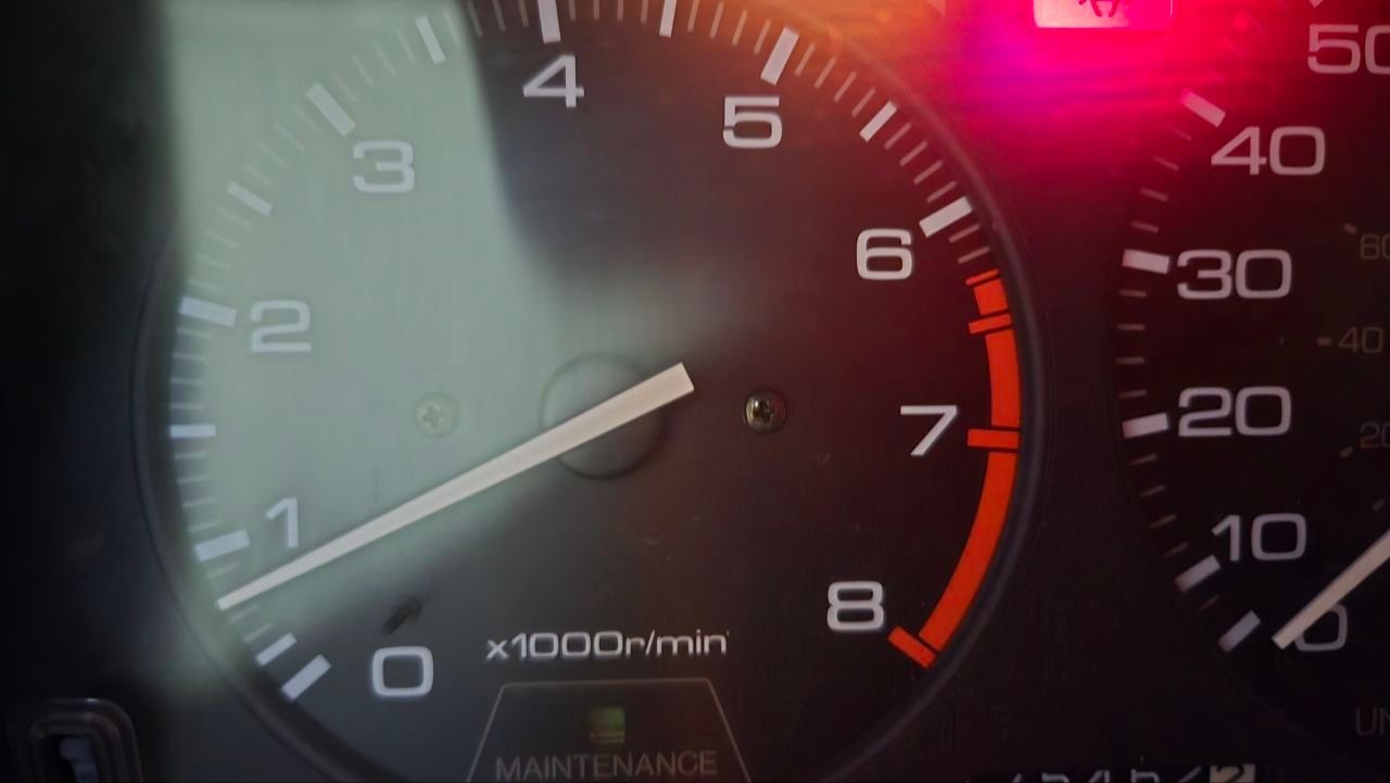

Here is the idle when fully warmed up:
I will do the last part soon.

So that last picture is a normal idle. Does the car idle normally once you reach that 750 rpm in the last picture?
