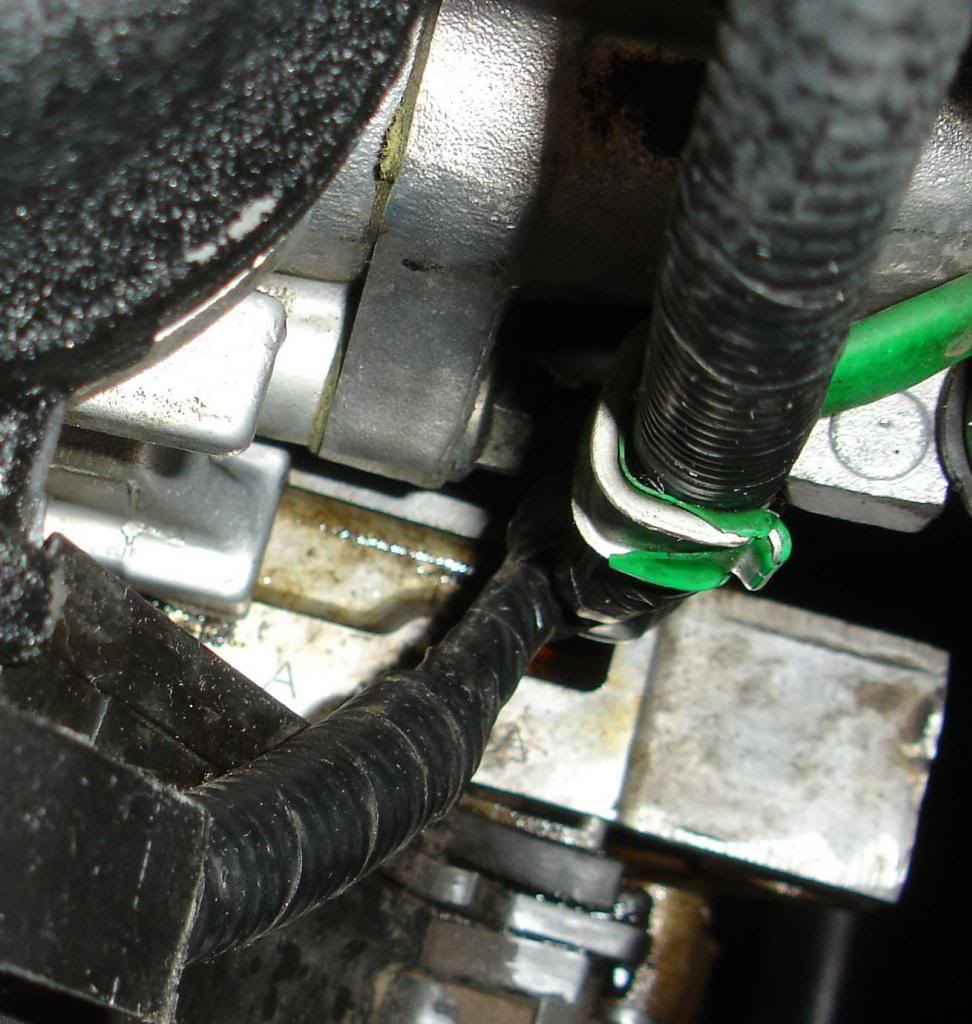

Took the car to the DIY car wash and washed the outside as well as extensively under the hood. I am amazed at how good the the engine compartment looks now -- about as good as it did after I detatailed the compartment for at least two hours before I did the timing belt job almost 7 years ago.
When we brought the car to a halt in the garage after taking the car for the wash, I left the engine running and lifted the hood all the way back to get a really good look at the area of the engine block just below the driver's side rear corner of the valve cover. Sure enough, there was fresh oil present on the little shelf. If my eyes didn't trick me, I think I could see oil leaking from that corner of the valve cover down to the little platform in the engine block a few inches below it.
I then waited an hour or so, went back into the garage, lifted the hood and cleaned the little platform shown below. I then tightened the four valve cover screws and started the engine. I observed no oil leaking out of the valve cover and, significantly, no oil leaking from the back edge of the top timing cover.
I then snapped the following photo:
I have placed a piece of cardboard that has a garbage bag over it under the car to catch any drips. I'm keeping my fingers crossed that merely tightening the valve cover fasteners has stopped the leak. (Wouldn't that be nice?) If it hasn't stopped it, I'll replace the cover gasket, observe the result and, if necessary, remove the top cover to see if it is the cam shaft seal that has failed, etc.

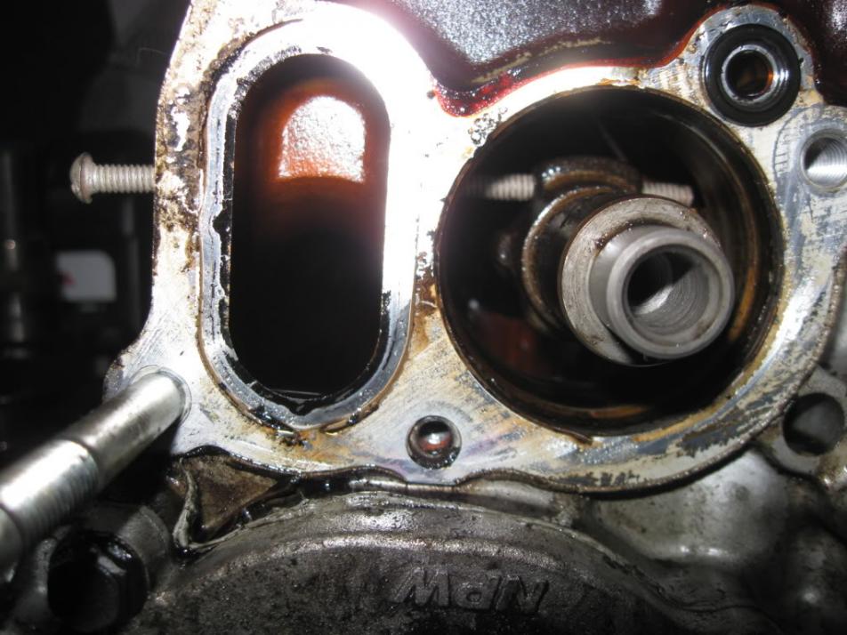

I have a question about the hole in the REAR balance shaft -- the one that is accessed by removing the access bolt on the firewall-side of the engine block, and the one into which you insert a rod or dowel or drill bit in order to ensure that the shaft is in the correct rotational orientation.
Does the hole go all the way through the shaft, or does it go only part way through?
The reason I ask the question is that if the hole goes all the way through, by inserting the rod into the hole from the wrong "end", that would position the shaft exactly 180 degrees incorrectly.
If the hole goes only part way through, the shaft MUST be in the correct postion in order to get the rod into it.
Anybody know whether that hole goes all the way through or not?
Thanks.
Old Jul 12, 2013 | 04:01 PM
  #67
Look at the pics closely. It appears to only have a hole on one side. The hole is not through centerline of balance shaft. It is below centerline. When rotated 180, it is not accessible at all.
PM your email address for a writeup I found some time ago about rear balance shaft alignment. It is tricky to get right.
Old Jul 12, 2013 | 05:15 PM
  #68
Here is a pic - thanks to "someone else".....yea it is upside down but you get the idea.....just a TX said, it is "off center" so it can't be locked 180 out.
