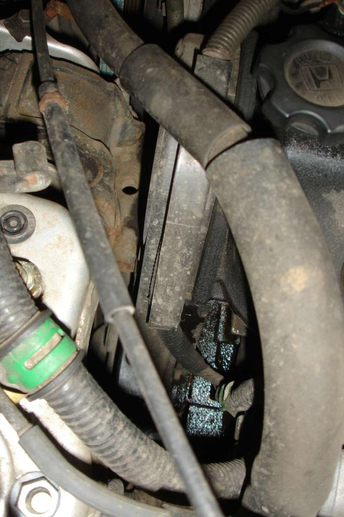

Are we sure this isn't just the valve cover gasket?....pic of the leak area.
Also, you can pull the upper timing cover and run the car and see "part of" what might be going on.

Here's a photo of the area. The view is approximately on the driver's line of sight toward the timing cover. (Perhaps a bit more above the driver's line of sight.)
I suppose it is possible that the valve cover gasket instantly started leaking, but I doubt it. I'll check out that possiblility anyway, though. It's a good, easy first step. I'll take the car to a wand-type DIY car wash tomorrow and blast clean the entire area that you see in the photo, then dry it off throughly and have my wife start the engine and see what I can see. The leak is fairly substantial, so in a few minutes I should be able to determine whether the valve cover gasket is in fact leaking. I'll be very happy if it is.
If it isn't, I'll probably take poorman's good suggestion to go through the steps to at least get the upper timing cover off. If it is the cam seal, I should be able to see it's trail, even if the engine is not running. If I can't I'll start the engine and then try to see what's what. How much does oil fly around above the cam and lifters if the cover is not in place while the engine runs? Is it like a lawn sprinkler?

You can lift the valve cover just enough to release the upper timing belt cover and then replace valve cover.
