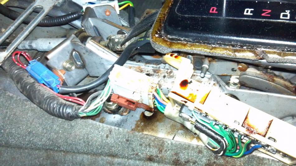

Step #3: Read on here it could be the Neutral Saftey Switch. I finally found it ( Under the gear shift console) Hooked my tester up to it startered glowing red so it is getting power to it. So its not that.

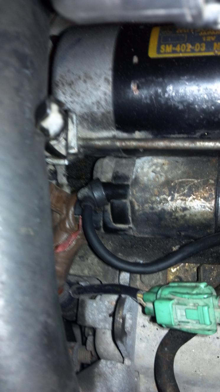

Step #4: The fella at O'Reilys said to check and see if it is getting power to selinoid. So I hooked the tester up to that and I didn't get a glowing light so it isn't getting fire.

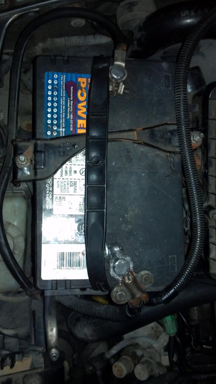

check all connections, battery, starter. likely just a loose ground, your battery terminals look suspect

To my1st.honda93 When I changed the camshaft seal I had to resit the timing. Could I have not set it right? Is the starter relay and the main relay the same? Im fixing to get out there and work on it some more ill check back in a few. Im gonna go get some battery terminal ends kyle102565.

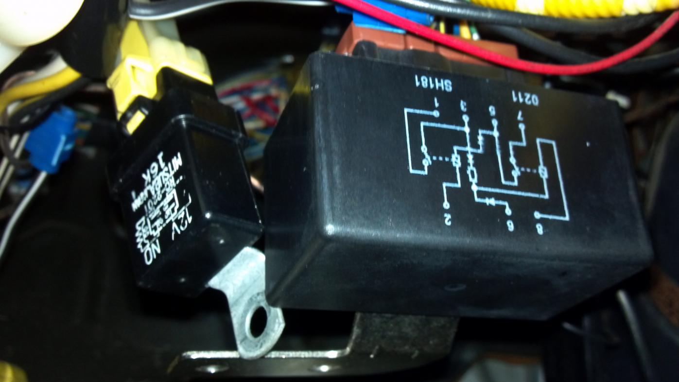

well ....changed the battery terminal ends still will not turn over. I found the Starter Relay in the relay box under the dash. I pulled it out and took it to O'Reilys the one he came up with was the same one as i replaced yesterday ( The main relay ) he said that that was the stater relay. I found a diagram online and this the one I pulled. Im fixing to go to Autozone and see what they have. Is it possible to just use a universal relay that matchs the one i pulled out I dont know much about relays.

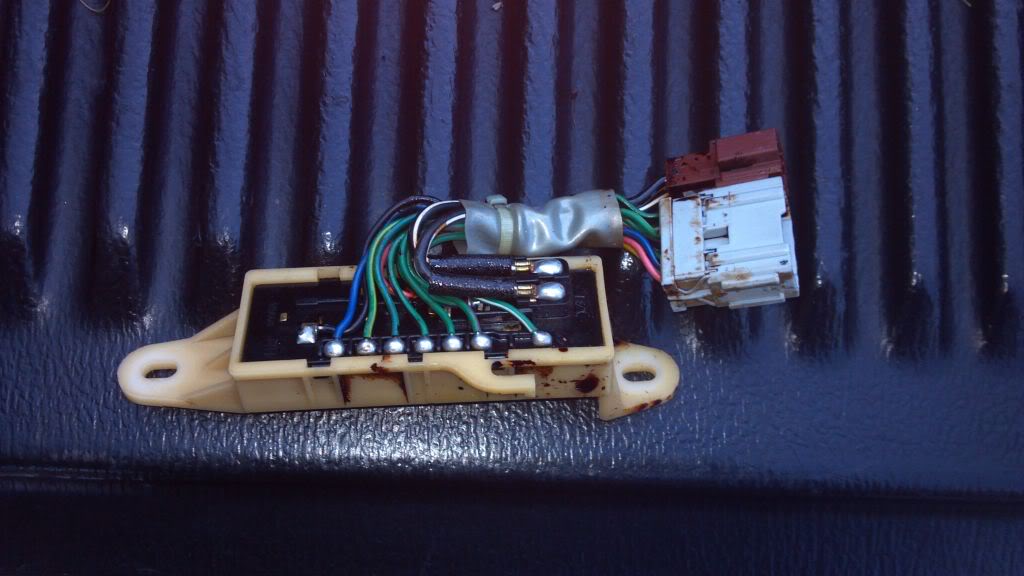

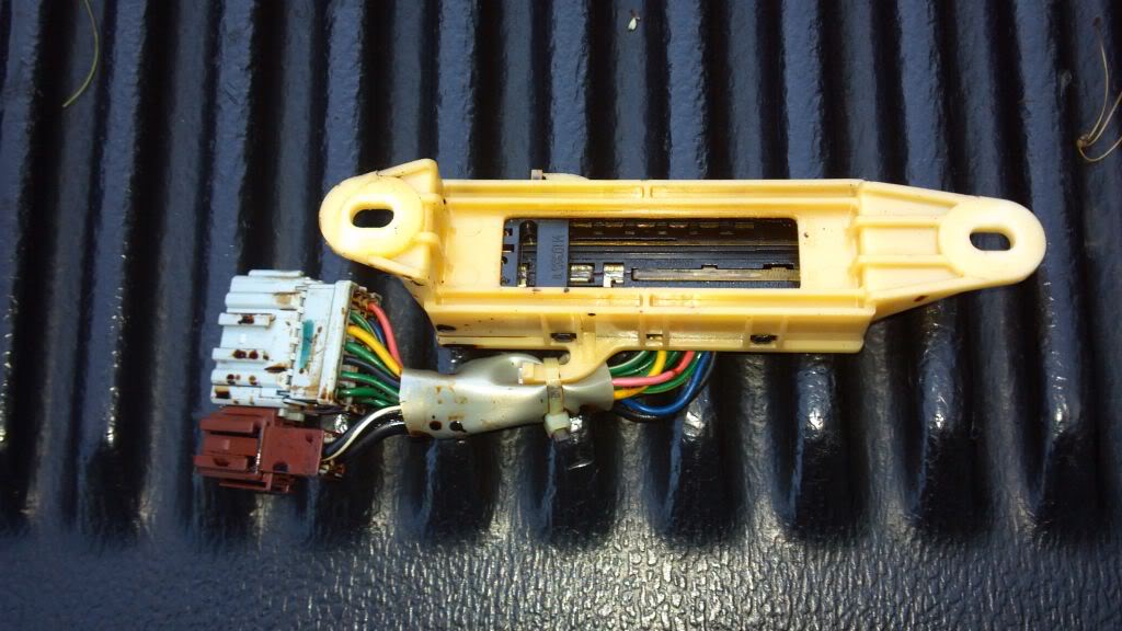

Ok this is not going to good. I swapped out the Neutral Saftey switch still nothing this is a pic of the old one.

I also changed out the starter relay under the dash still nothing. The hot whire on the selinoid is hot ( Tested it with a tester) the black wire that is on the sellinoid does not have fire ( tested it with a tester ). I did not see 12V on the starter wire anywhere.
