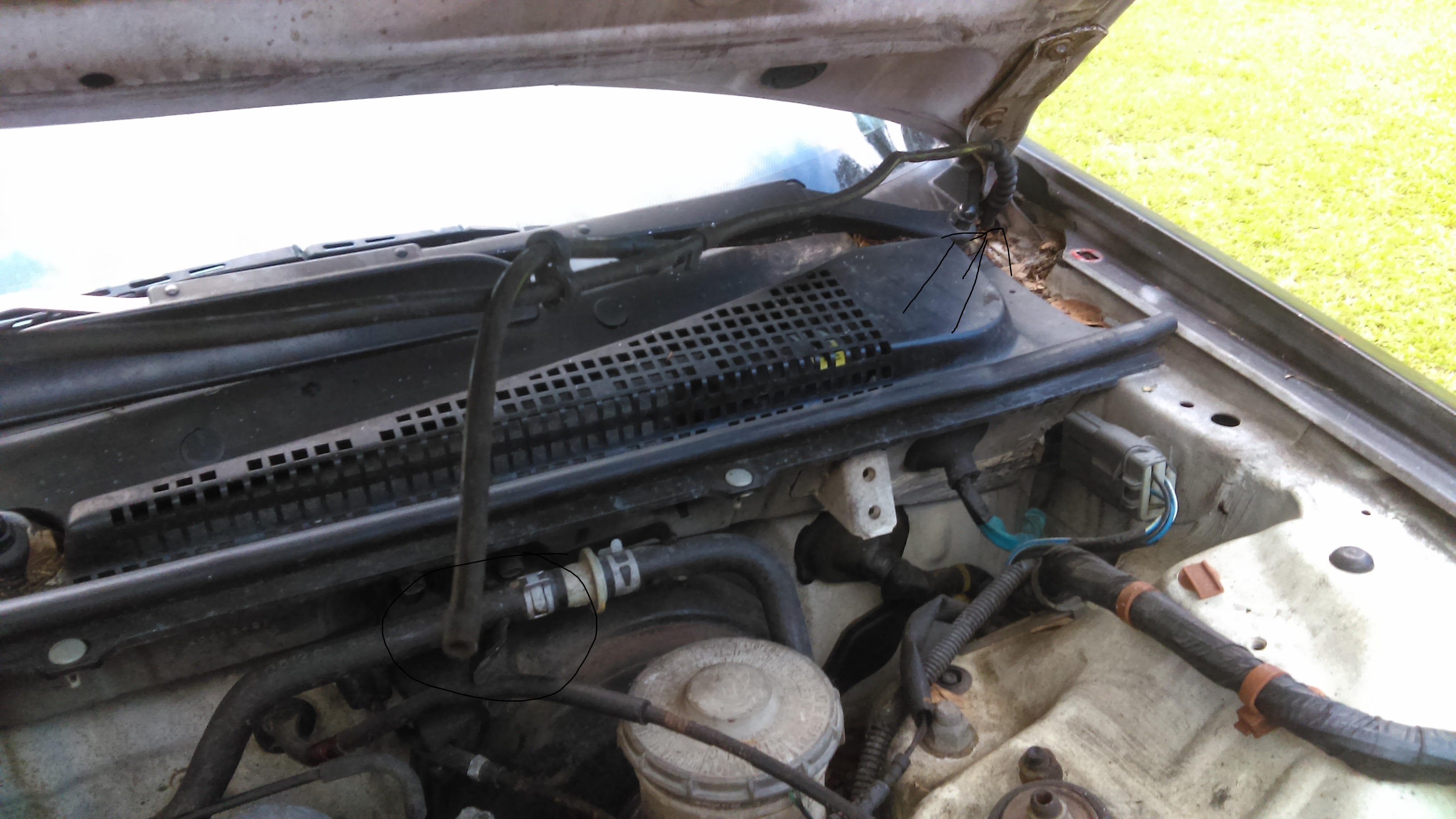

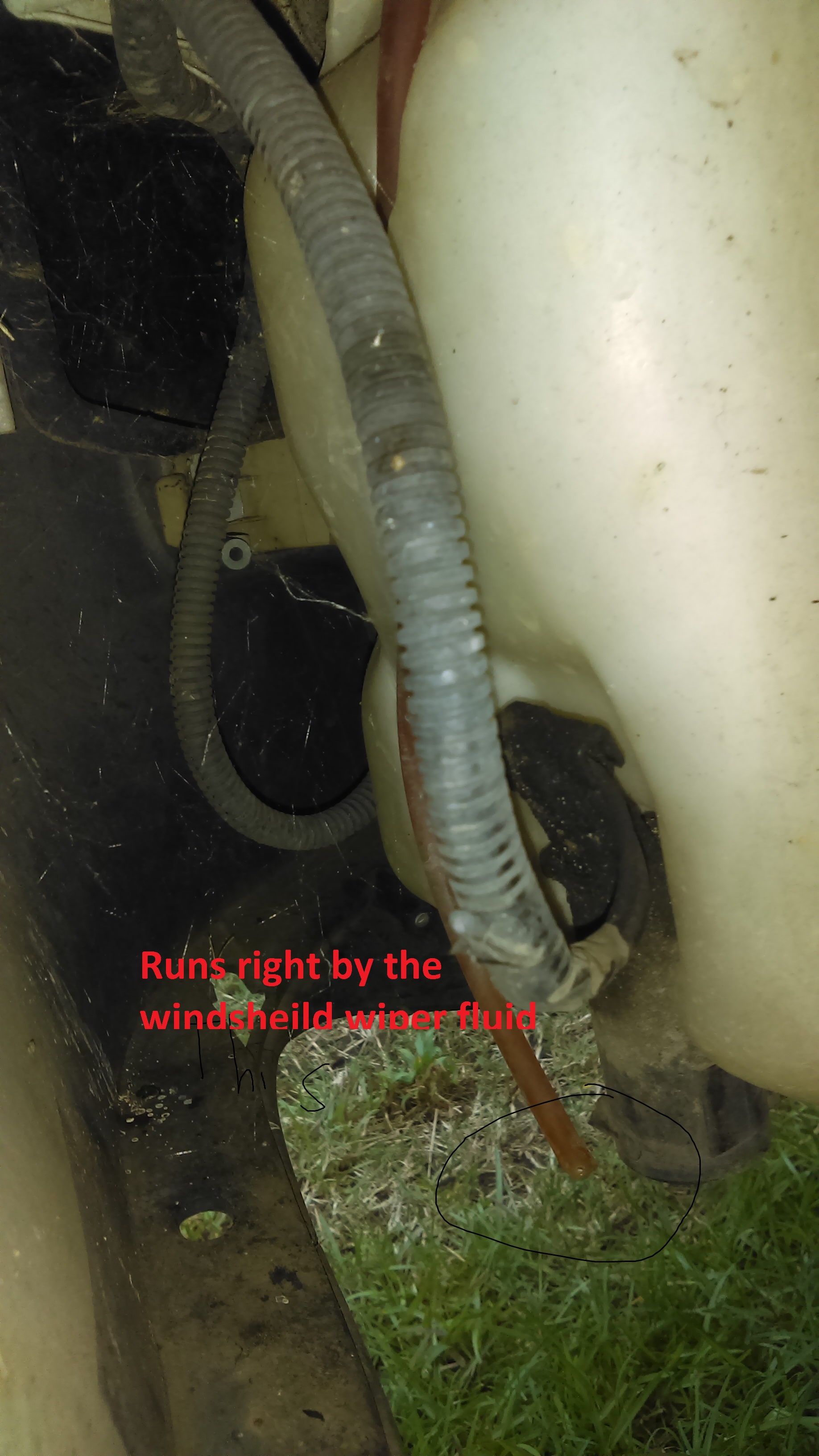

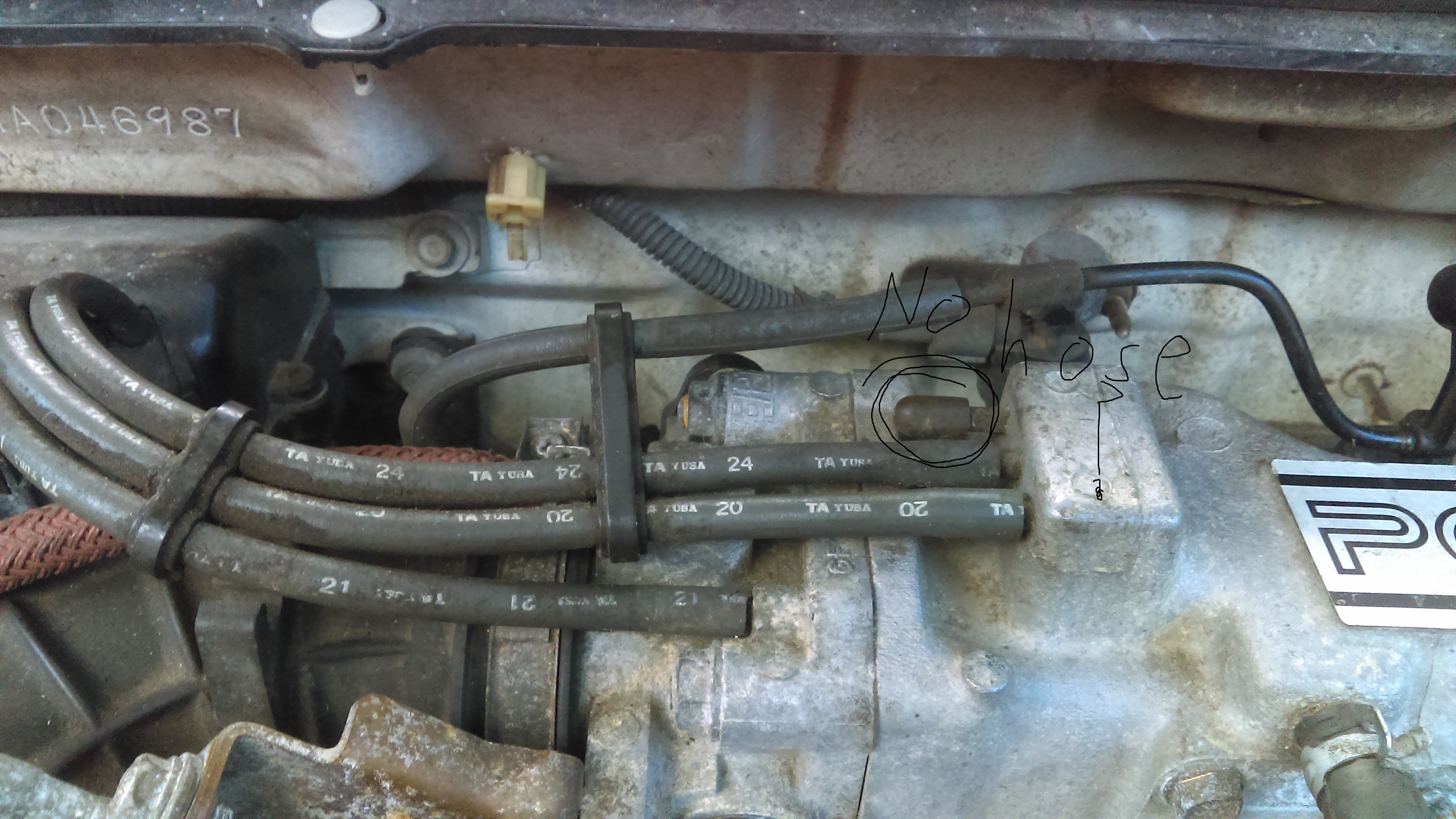

I just bought a 92 accord. I don't really know much about it. I was looking through it and noticed this hose wasn't connected. I think it has to go to the fuel injector. but i followed the hose more and it has been cut and I can't follow it anymore. I have no clue what this hose is. need help.

1. The first picture is the hose to that should go to the windshield washer nozzle.

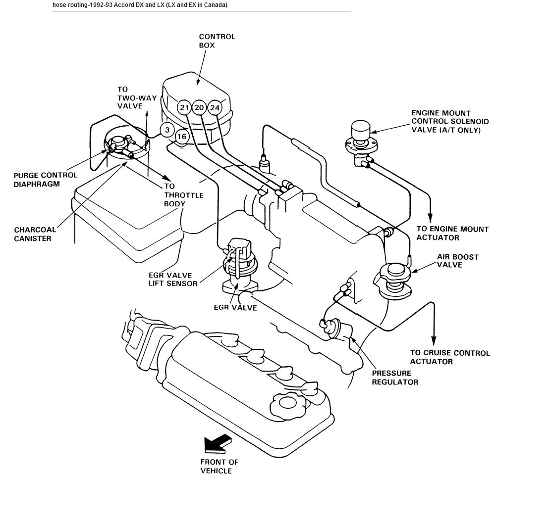

2. The second picture with the rubber plug is like that for LX and DX trim levels. For EX trim level, a vacuum hose goes to the intake control solenoid valve.
3. In the third picture, is there a hose connected to the windshield washer reservoir motor? If not, that may be the hose that should be connected to it.

Yeah, there is no windshield wiper anything in the car I don't know why guess they got rid of it. But without those hoses connected everything should still work fine?
Old Aug 21, 2016 | 06:37 PM
Those disconnected hoses should not have any effect on the engine.

I guess the people I bought the car from took out everything else from the windshield fluid stuff .all that's left is the hose and the tank.
