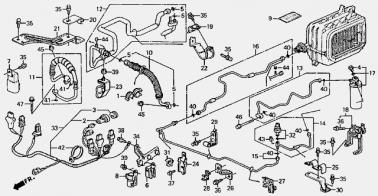

Hey guys, Ima getting into my A/C soon To Find specific leaks...I got a very obvious area on the High side. Are there any real common leak points I should look for, Gonna start cleaning all the gunk and grime off tomorrow. The system is dead flat on a charge, Gonna pressure up w/ Dry Nitrogen gas to locate the leaks... Lemme kno if ya kno of any real common ones besides the obvious , like at the gauge hose connectors...ty ...See attached photo Dave...13SM20_B60.jpg

common leak points; compressor shaft seal, r12 to r134a adapters high and low side especially if you got the cheap ones(leaks when attaching coupler), schrader valves, condensor due to impact damage, pressure switch, I had a leak where the evaporator clipped to the expansion valve. I changed both since the evap fins were filled with crap and corroded.

When I had my 92 it leaked from the pressure sensor twice, but that was the only A/C problem it ever had.

At this age the orings attaching expansion valve to evaporator and pressure feedback line to expansion valve are almost certain to leak. I found leaks on a 90 and 94 Accord when removed. Also by this age, there's bound to be a lot of debris in the evaporator case.
Evaporator leaks cause is dissimilar metal corrosion at brass/aluminum connection junctions. A white powder is formed which pushes on the oring, eventually distorting enough for a leak.
Fortunately, removal of the evaporator is very easy on this model Accord.
Also a good time to replace the blower if it's never been replaced. The brushes wear out and fail. W/ evaporator out, it's a little easier. However, it can be replaced w/ evaporator in place.

Are u talking bout the tubing connectors on the engine side of the fire wall, or are there more in side the fan/Evap housing ?? Im seeing signs of leak over by the Pressure switch and High side line up in the drivers side front corner where the P/S is...KK thanks for the info...Dave

The tubing connections in the evaporator housing. Evaporator housing must be removed, split, and opened to access/replace the orings. You can get an accord oring kit from ackits.com, ebay, or match them after removing.
Leaks will be indicated by dirt/oil accumlation around the connections and on the evaporator.
Clean connections w/ plastic brush and light use of fine steel wool to remove corrosion and polish, but not scratch the sealing surfaces.
AC repair can be rewarding, but it must be done right. Read autoacforum.com for tips on ac work.
