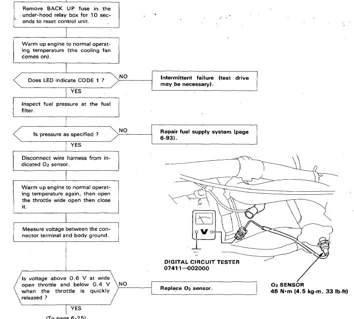

Old Oct 22, 2011 | 08:00 AM
Here is a start
