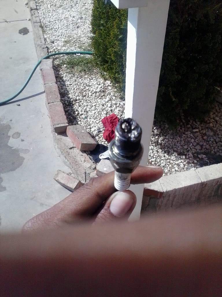

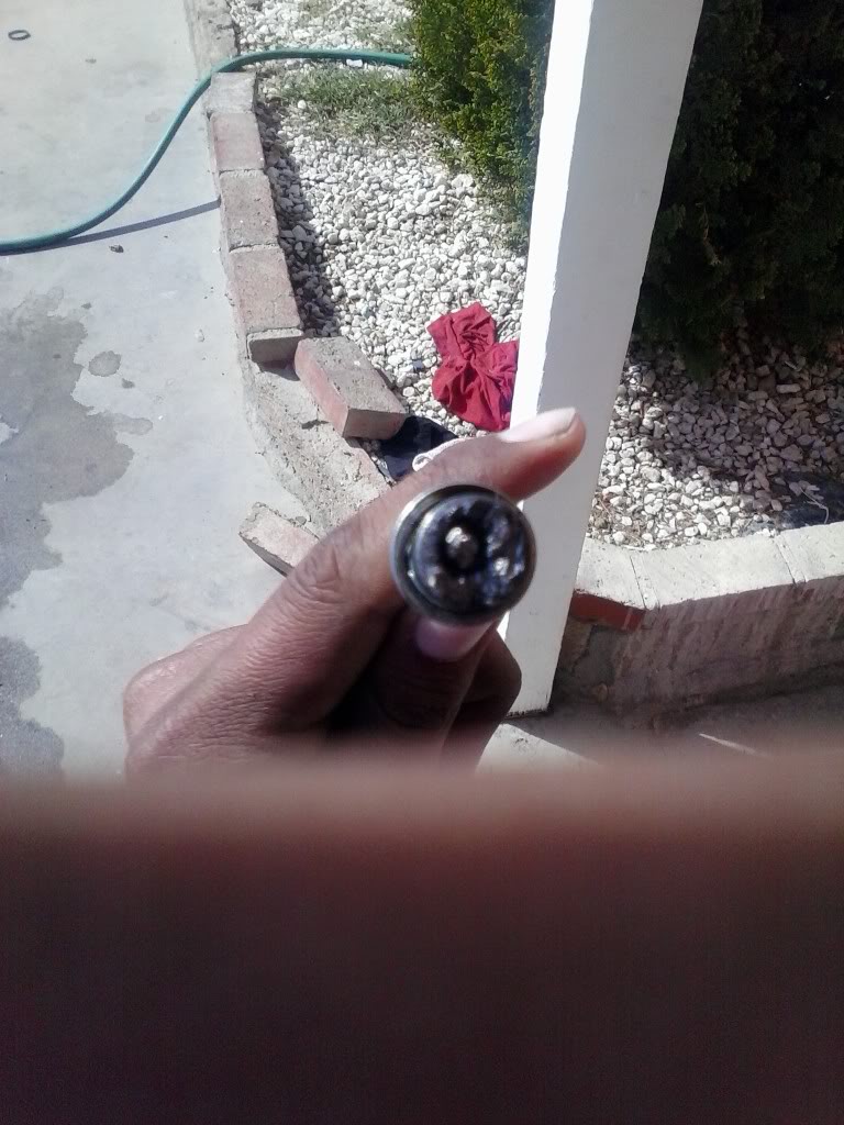

compression check results - 0 across the board. when i was pulling the spark plug i found this in cylinder 2
I had someone crank it with the sparks out and the pistons are all moving, why would there be no compression.
