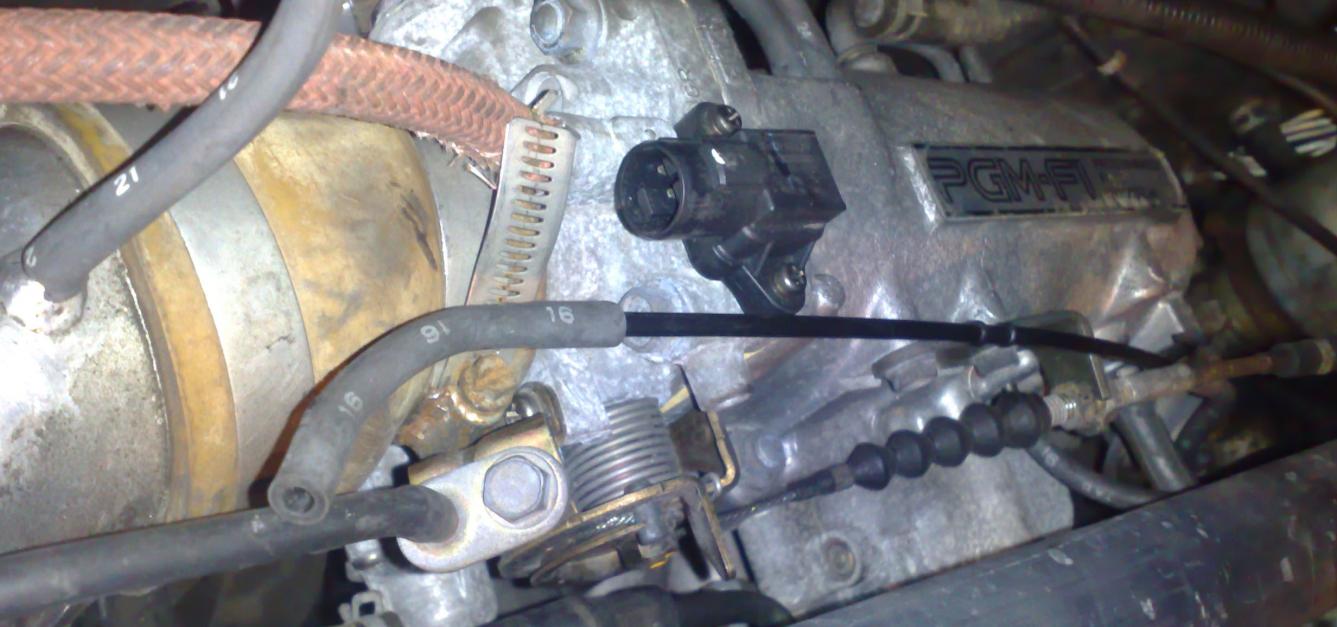

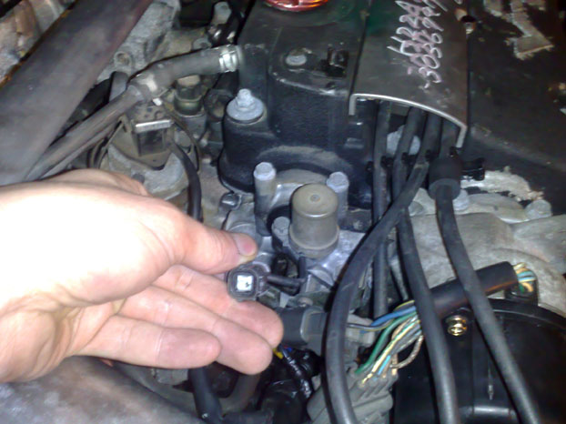

plus I don't know what's up with either of these loose ends, maybe this explains
Attached Thumbnails 93 accord h22 swap problems-sensor1.jpg   93 accord h22 swap problems-sensor2.jpg

In the second picture, there is a vacuum hose #16 that is not plugged in and the map sensor is not plugged in.
The first picture looks like something with the vtec is not connected.
What you should do is check for error codes. The procedure should be the same as for your 93 accord, so read the DIY writeup called how to get cel codes.
