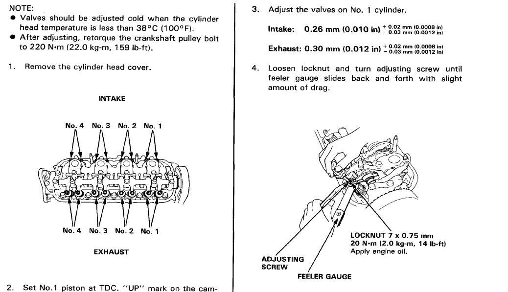

Should be on the sticker under the hood.
Do this with the engine cold.

Good diagram Mr. H...
