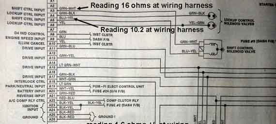

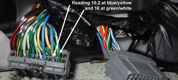

I'll double check the connectors again. For now all I had time to do was check resistance at wiring harness of TCU. I did get a lower reading (10.2) on blue/yellow wire, so I'm thinking that might be it. I'm attaching picture of harness in the hopes someone can let me know if I'm reading the right ones.
I'm also attaching the wiring diagram from my Haynes manual which leads me to believe they are the ones for the shift solenoid, which according to the TCU code 7, would be the problem.
If indeed it is, I need to bypass that wire temporarily to see if it works. Problem is, I can't detach it. I've used all sorts of pins to release it, to no luck. Does anyone know how to detach these? The other option would be to cut the wire, but that would be a pain to splice in those cramped quarters.

I think, if you use a small "jewelers" screwdriver (flat head) from the female side of the connector at the top, that will allow the "tab" to be pressed down enough to remove the wire from the connector. A "pin" or small wire paperclip might work
