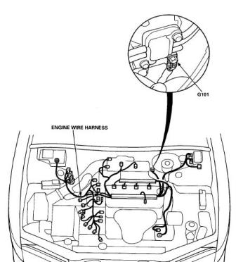

A few things to check. The main ground on the drivers end of the tb (G101).

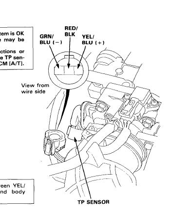

What are the colors of the three wires currently connected to the tps?
I'm sorry but what is a t.p.s?

Throttle Position Sensor (TPS). It is right where the intake hose connects to the Throttle Body (TB) on the back firewall side.
