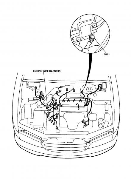

The ignition switch can be tested when the car stalls by checking for voltage to the blk/yel wire going to the distributor when the car stalls out while leaving the key in the II position. Can you get the engine to stall out by shaking the key while the engine is running?
There is a ground on the driver's side of the intake manifold that you may want to unbolt, clean the bolt and eyelet with a wire brush or sand paper, then reattach. That is the main ground for the engine computer. See G101 in the picture below.
