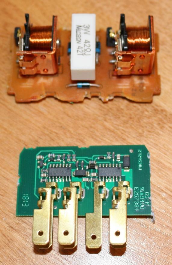

Car has been running well up until yesterday (1 yr) when it wouldn't start. During the 3rd try it was up and running. This was after being in the grocery store for about 10 minutes or so.
Replaced the main relay and so far no problems but I know it may be something else.... I should have listened and paid more attention to the fuel pump running when I turned the ignition key but did not.
The new Duralast replacement from Autozone is actually a solid state unit (see attached pic)! Old one is up above and partially disassembled so that I could see what condition the relay
contacts were in. Soldering all looked fine.
July 19, 2014: Car is running fine with the new solid state main relay!
